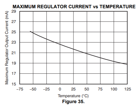

XTR111: What is the maximum source current of REGF terminal under all temperature range?
Part Number: XTR111
 Hello guys,
 One of my customers is considering using XTR111.
 They have a few questions as the follows.
Q1. What is the minimum source current of REGF terminal under all temperature range?
Q2. We need 3mA source current from REGF as the minimum under -10 degree C ~ +85 degree C.
       Can XTR111 source 3mA?
 Your reply would be much appreciated.
