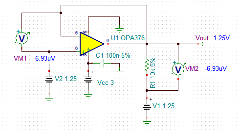

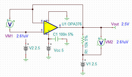

we have used the OPA2376 in a high DC accuracy system, and we have found the DC offset over max spec limitation mentioned in datasheet, like 30uV , so need your help if this is normal or have some issue. we measured the offset with a 8 1/2 multi meter, so the measurement method is ok.

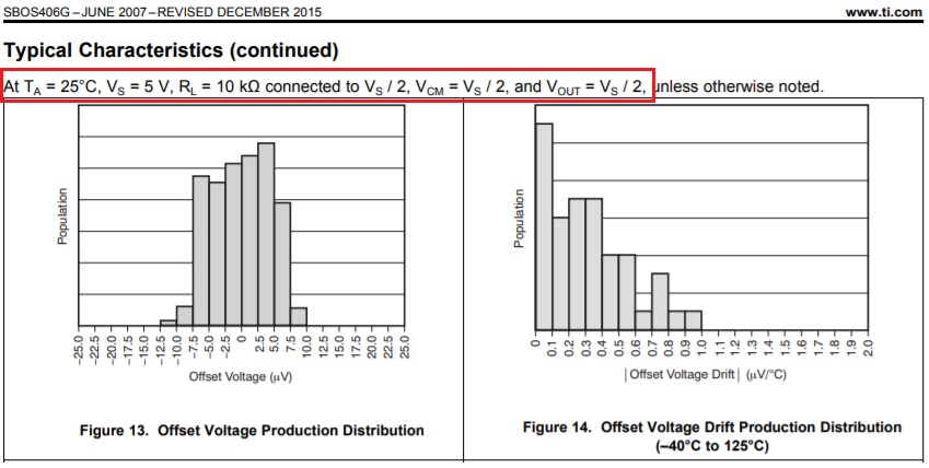

Our datasheet typical offset is around 5uV. So does the additional offset is from the soldering stress? or how we checked the offset spec in our bench?
