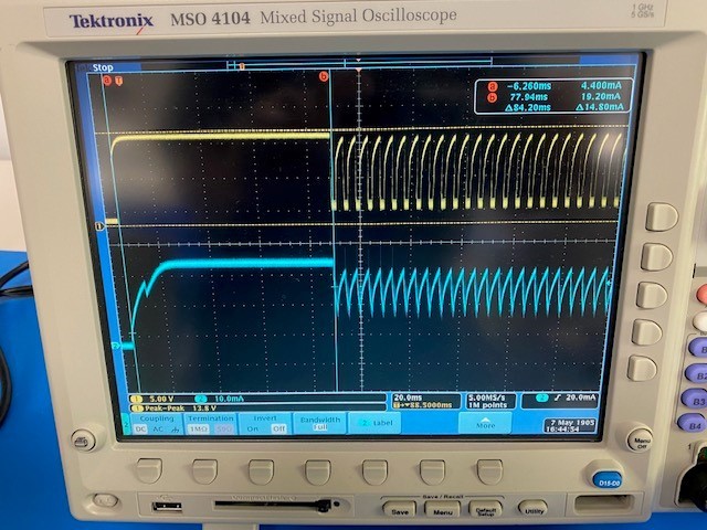

This is a continuation of the DRV120:DRV120 posting. I am using the DRV110EVM and changed Rsense=4ohm. I want to achieve the following setup using a 24 volt power supply:
I Peak = 26 mA
I hold = 15 mA
Ckeep = 100ms
I have these settings on the DRV110EVM using your spreadsheet:
 Question: After enable is asserted, the circuit stays at 26 ma and never reduces down to 15mA after the Hold time (100ms). What is wrong? Since I am using 24 volts, do I need to modify the DRV110 Zener external resistor to 7.725Kohm as per the spreadsheet to make this work?
