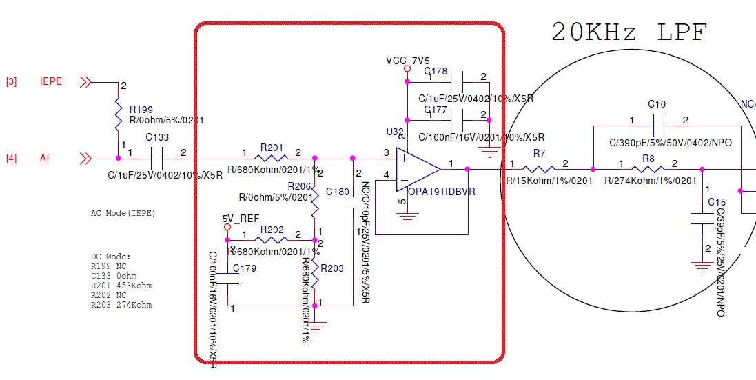

my customer design OPA191 and need us to double check is their schematic ok or not.
Please help to check.
Atfirst, the AI side input signal voltage range is +/-5V and the OPA191 output should become 0~5V voltage range, so it should act as level shift.
Please suggest.
