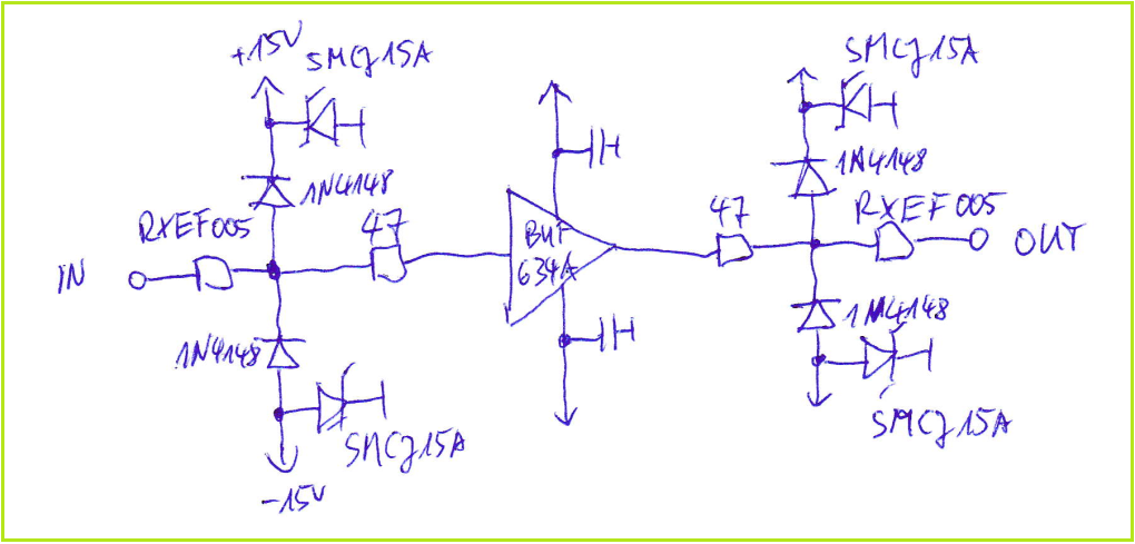

I am deciding which TVS to use to protect the Vs and Vinput.  The data data sheet says max is +/-18V or 36V for supply.  Max Input volts says +/-Vs (which I assume means 36V).  If I pick a bidrirectional TVS that clamps at 36V, would that protect the Vinput port?  Is 36V the highest I dare go?  (Actually using a BUF634P

  • Whatever supplies you use, there will be about a 2V headroom to those supplies for linear operation, so a TVS 1 V less than the supplies will not turn on in the linear range but will before overdrive to the supplies. Note the BUF634A is the newer version of this.

  • Sure, see enclosed - hopefully I did that right....
    Note one is for the PCB, other shows connections to the outer enclosure.  Part of the idea is to protect the ICs from damage from a meggar, normally at a 50VDC setting (which should not be done on this box, but has happened).
     Part of the problem I have seen in selecting a TVS is one that has a  reverse standoff or breakdown voltage of 15V has a clamping voltage of about 21V.
    With a supply voltage of 15V, I don’t want the TVS to start conducting.
    Thanks for your continued interest in this.

  • Hi Steve,
    I would give this diode clamp a try:
    I prefer using low leakage TVS (e.g. from ST).
    Of course, the protection scheme could affect the signal behaviour.
    Is the 50V coming from the meggar in some way current limited?
