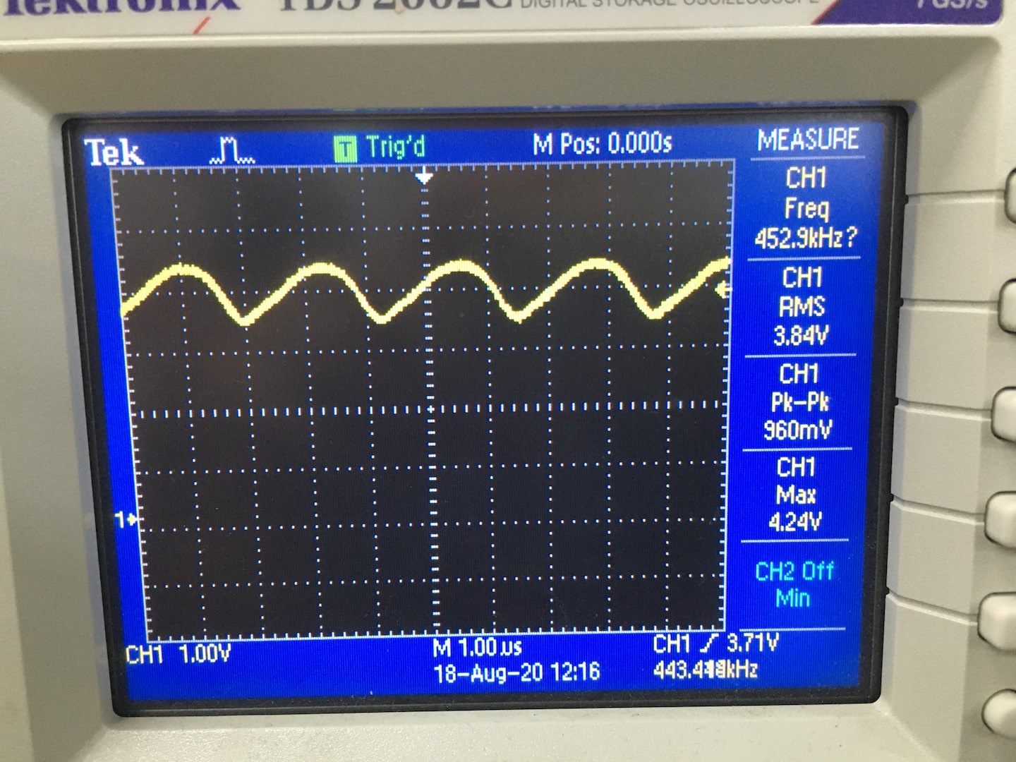

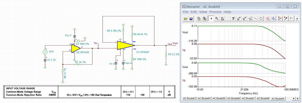

I have made a battery simulator based on OPA567 (see picture). However, the output voltage contains the high ripple voltage (see picture) when no load. I have checked voltage at tespoints VDAC, 1.8VREF but there are not any ripples. Could you teach me how to filter out these ripples? Thank you.
