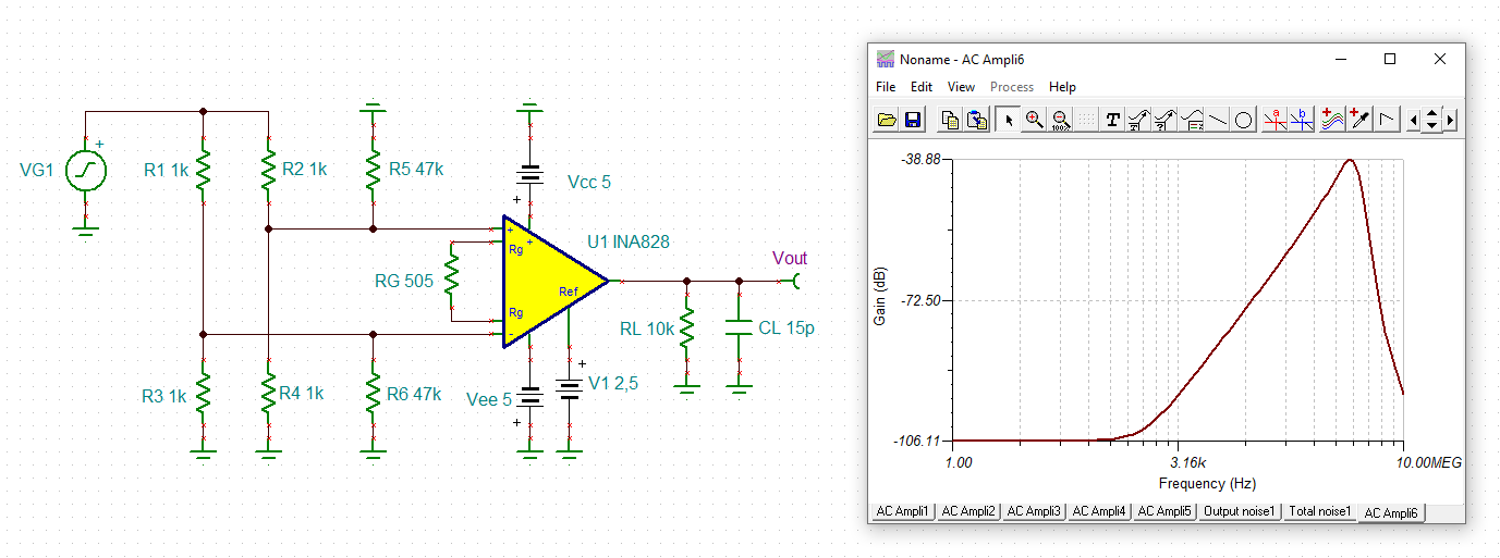

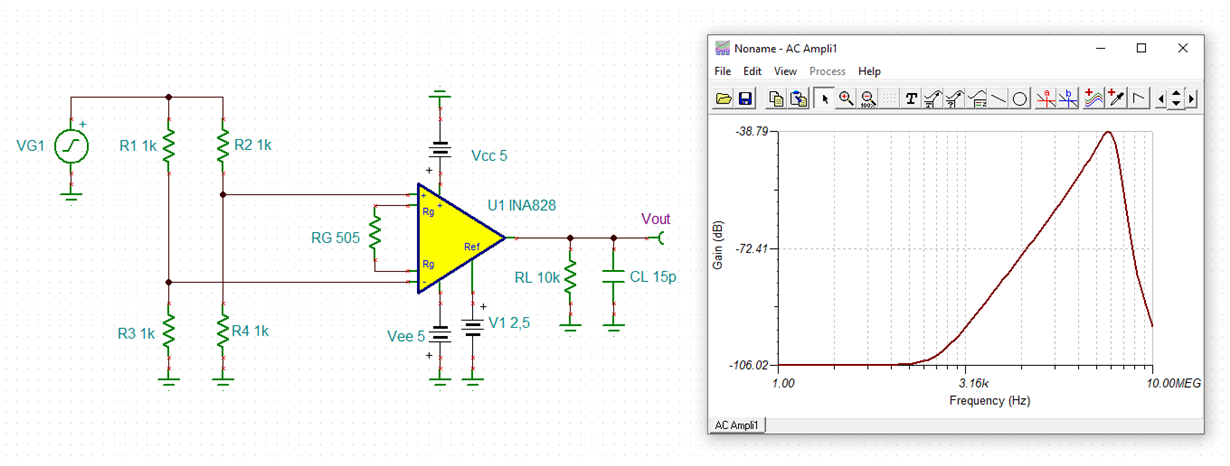

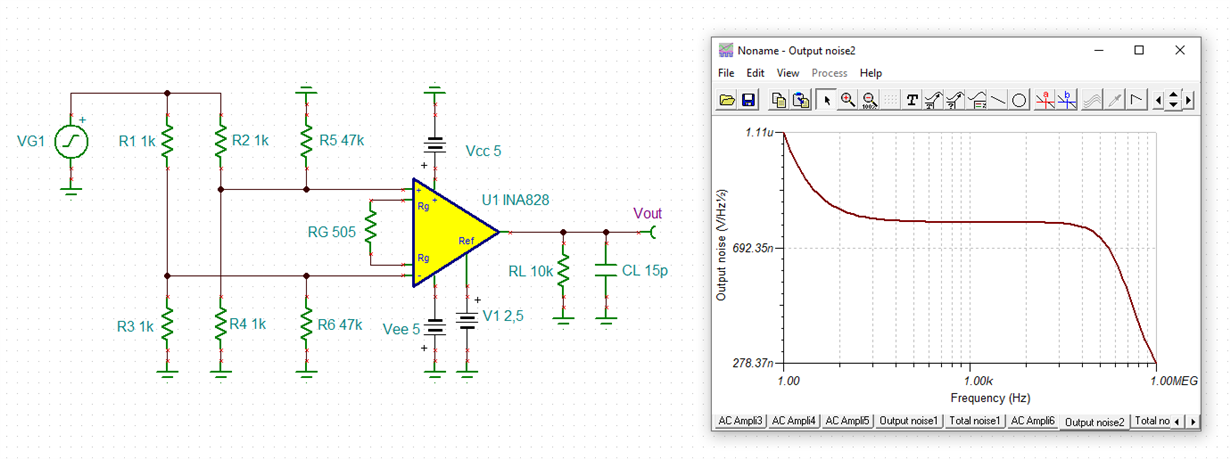

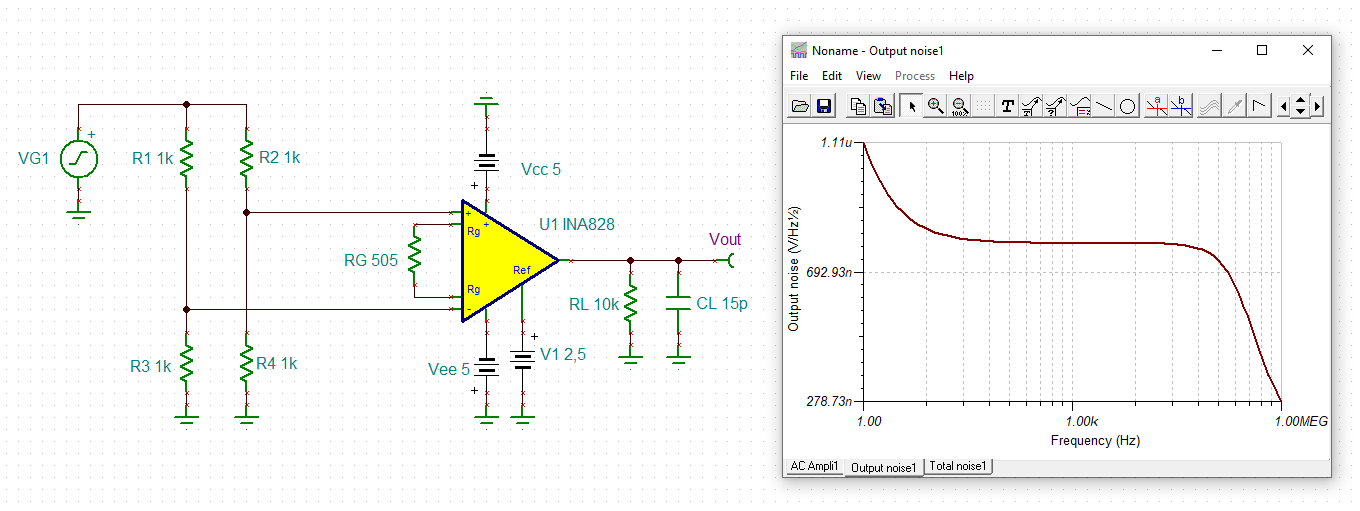

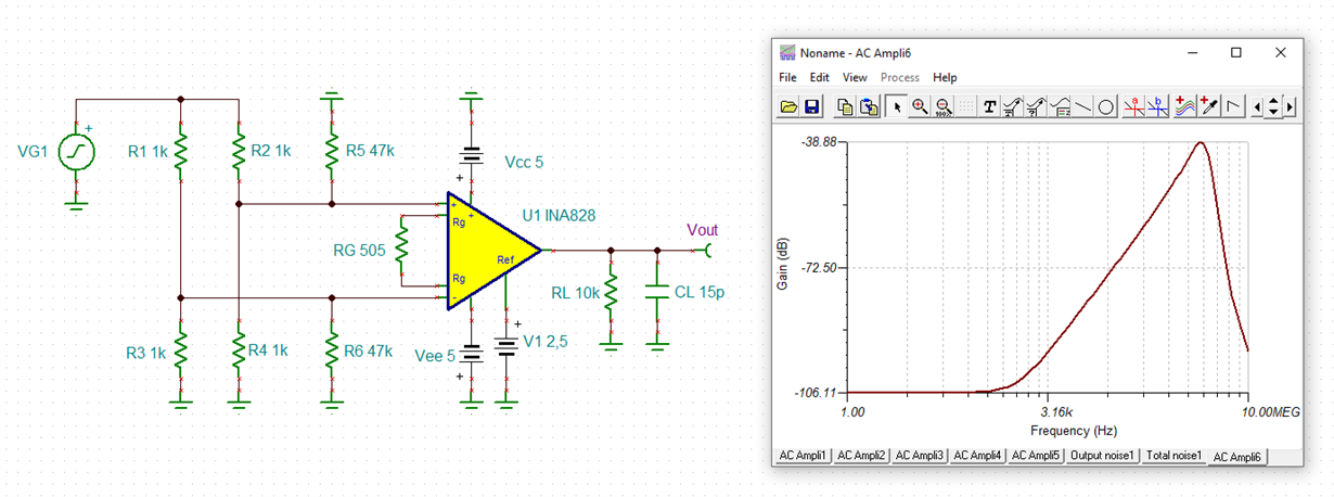

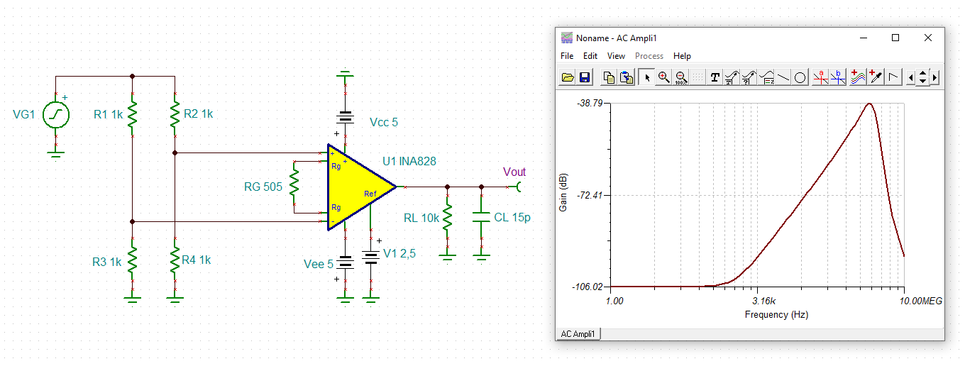

I have a question regarding the Input Bias Current Return path section (8.2) of the INA828 datasheet. I'm using this instrumentation amplifier to amplify signal from a wheatstone bridge. The Supply is +- 5V and ref is 2.5V. I do not think that I need to add this resistor to my design since the differential input source impedance is low. Adding resistor will increase noise in my system and also change the balance of the bridge. Please confirm.
