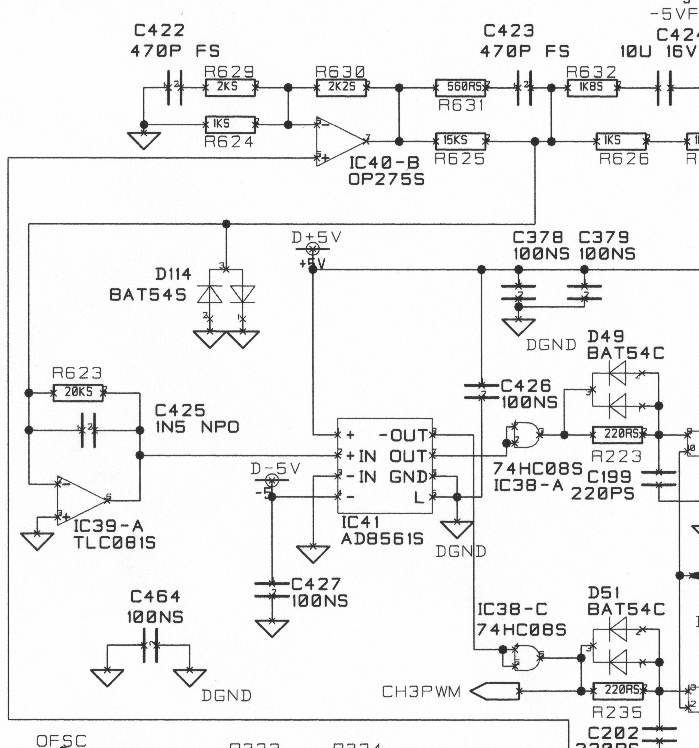

I'm working with a mature high power Class D amplifier design, and am having some issues with noise generated in the naturally-sampled PWM modulator. This comprises a simple analog ramp generator (an op-amp based integrator, creating a roughly 150kHz triangle wave) and, at present, an AD8561 comparator from Analog Devices.  The noise present within the input stage of the comparator appears at the output PWM as a random jitter of the edges -- effectively the comparator input voltage noise is added to the desired signal, and modulated along with it.  Given the amplifier's relatively high power (main rails of +/- 150V DC) the output stages effectively apply 30dB of gain to whatever input noise exists within the comparator -- but nobody seems to be able to comment on how big this is, and which comparators might be chosen as alternatives to help reduce the issue.
The problem is NOT to be confused with the multiple output transitions that can be caused by inadvertent feedback around the comparator.  These aren't a problem (the comparator actually switches very cleanly, thanks to careful attention being paid to decoupling, PCB layout and the fact that both inputs being driven by very low impedance nodes).  Adding hysteresis does NOT help with my specific issue; DC coupled hysteresis simply displaces slightly the threshold at which the comparator switches, and then speeds the transition once it's begun. Adding AC hysteresis (that is, a small positive feedback capacitor) only helps to speed a transition once it's begun.
The noise voltage - which IS the problem -  also shifts the comparator's switching threshold, but does so randomly and regardless of whether any hysteresis is added.  Measurements confirm the total lack of improvement by adding hysteresis.
Can anyone help shed light, please, on the sort of input noise voltage density we may expect from an analog comparator of the TL3016 (which is TI's version of the LT1016m itself something of an industry standard and the predecessor to ADI's AD8561) ?   Is there a general trade between comparator speed and input noise voltage?  Any recommendations for a lower noise alternative?
Thanks in advance!   - Mike Turner

  • Hi Michael,
    can you show the schematic of the comparator's section? Just to see how you drive the inputs of comparator and what is connected to the output :-)
    Kai
  • Hi again Kai
    The comparator inputs are at low mpedance; the non-inverting input is driven by an op-amp, actually an NE5534A, and NOT a TL081 as shown.  Under quiescent conditions the signal here is a +/- 2V peak triangle.The inverting comparator input goes straight to ground. The +5V and -5V supplies are clean and quiet;  and I should re-iterate there's no problem with multiple transitions at the comparator outputs.  The outputs each feed 74HC08 gates which act as buffers and which then drive simple monostables to add dead-time.  The latter aren't the best practice IMHO - but the're really not part of the present concern. (I'd prefer at least proper Schmitt trigger input gates after the monostable RC time constants, to help avoid introducing timing jitter here - maybe even proper dedicated monostable IC's).

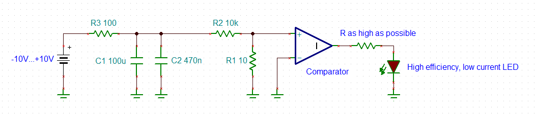

  • Hi Michael,
    to get a feel for the input referred noise of comparator, I would build the following test circuit:
    +/-10V comes from a low noise voltage supply. Low pass filter R3, C1 and C2 provides additional noise filtering. R2 and R1 form a 1000:1 voltage divider. Of course, you can adjust the division ratio to your needs. R1 presents a low ohmic source resistance to the comparator input as in your original circuit. By this the input noise current plays a similar marginal role as in your original circuit. Now carefully and slowly decrease the input voltage from +10V to -10V and check the output of comparator for togglings.
    The circuit should be very well shielded. The comparator should be supplied by batteries (other than the +/-10V input voltage!) and the supply rails of comparator should be low pass filtered by a suited RC network. Have the batteries within the shield as well. Eventually an additional 100n cap across R1 might improve the results.
    Don't connect a scope, voltmeter or else to the output of comparator, as this can introduce additional noise to the input or signal ground. To check for togglings I would connect a LED needing ultra low current to the output of comparator.
    Kai
  • Hi Michael again,
    I would treat the comparator as an analog circuit,  an analog circuit which is very sensitive and providing a very high gain. So I would connect its signal ground to the analog ground, not the digital ground. And I would avoid powering the comparator by the digital supply voltages. At least add RC filters or RLC filters to the supply voltage pins of comparator and 74HC08.
    Eventually, revise the signal ground routing so that no digital supply or ground currents are flowing through the comparator section. Individual RC or RLC supply voltage filtering can help a lot in this attempt. The 74HC08 circuitry which is producing lots of supply and ground noise should be isolated from the analog and comparator circuitry. Use a solid ground plane and separate the digital and anlog circuitry (including the comparator) from each other. Insert isolation resistors between the outputs of comparator and the inputs of 74HC08.
    Kai
