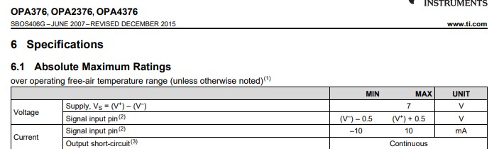

We have a design where an external voltage is divided down and fed into the OPA2277-EP. In this application it's possible for the external voltage to be present before the op-amp is actually powered. So if I consider the inputs of the op-amp to be infinite impedance then I quickly exceed the 0.7V absolute max input voltage (rails being at 0V). However using the spice model I see current flowing into the op-amp terminal once input voltage reaches about 480mV. At my max external voltage and with the divider configuration on this application I see 70uA flowing into the input terminal of the OPA which is enough to keep the input voltage below 0.7V. Now is the spice model accurate in modeling this scenario? Is there a safe number for how much current can flow into the OPA when its inputs are overdriven before it gets damaged?
