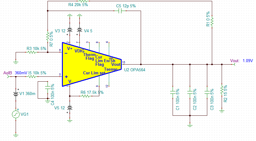

Hello
Oscillation is occurring due to the load capacitor of the OPA546 output stage.
I attached the Simulation file.
1. Do you any recommended load capacitor capacity for remove the oscillation?
2. Do you oscillation data provided according to the load capacitor?
OPA564_200822.TSC
Best regards
  • Hi Louis,
    Op Amp does not like to drive larger capacitive load. With 300nf capacitive load, the feedback loop has to be compensated. Enclosed is the compensated loop that should be stable with 300nF capacitive load.
    The following circuit will have unity gain BW at approx. 679kHz with phase margin of 72 degree.
    /cfs-file/__key/communityserver-discussions-components-files/14/OPA564_5F00_200822-modified.TSC
    If you have any other questions, please let us know.

  • Hello Louis,
    The OPA564 is likely to oscillate with the three, 100 nF capacitors connected from the output to ground due to phase margin degradation. That is a common behavior for most op amps when they are pressed to drive a high capacitance load. Added the appropriate compensation should eliminate the oscillation.
    What kind of load must the OPA564 drive besides the three, 100 nF capacitors? Can the output signal path tolerate a couple of Ohms of series resistance, or would the voltage drop be an issue? There are several different compensation methods that we can consider if a simple, series output resistance isn't doable.
    Regards, Thomas
