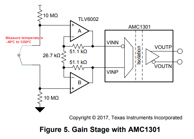

I am developing "Isolated Thermocouple Temperature measurement " using the given part , My application is to measure (-40C to +1200C) temperature. i was just going through the App note of TI "Thermocouple Temperature Measurements Using Isolated Amplifiers". and i am interested to develop the similar logic circuit as "Figure 5-Gain Stage with AMC1301" on "page-2" , i was just reading and calculating the given examples in the left side paragraph about how this IC will convert temperature in "mV" and after that I also understand how ICs Gain adjusted. My questions are,

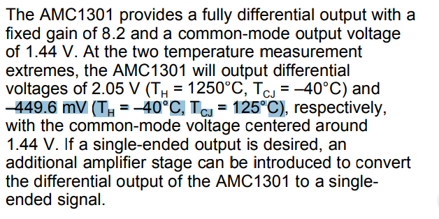

1) How to calculate Final output voltage of "AMC1301" at (TH = 1250°C, TCJ = –40°C), i need full explanation if possible, as i am calculating the given example on Right side Paragraph 2.05 V (TH = 1250°C, TCJ = –40°C).
2) i am not getting the answer for the right next example of it which is "–449.6 mV (TH = –40°C, TCJ = 125°C)" , i have tried same method as above example but not getting -449.6mv".
3) so if possible please give me full explanation how you calculate the Final output voltage , (Any other app note or document will also good).
4) i dont understand what is "common-mode output voltage of 1.44 V" in the same example.
explained answers will be really appreciable.

    1.3. 4. Figure 24. Output Voltage vs Input Voltage in the AMC1301 shows the relationship between input and output voltage for the AMC1301. The input range is +/-250mV, with a fixed internal gain of 8.2. This yields a differential output voltage of 2.05V for a 250mV input. The output common-mode voltage is the center-point of the differential output of the AMC1301. If 0V is applied to the input, both outputs will be at 1.44V as shown in Figure 24. Output Voltage vs Input Voltage.

    4) Please explain me how this is calculated as shown in below image, "–449.6 mV (TH = –40°C, TCJ = 125°C)" . How in this -449.6mV is calculated?

  • Hi Harit,
    I have verified with the author that the 449.6 mV is a typo. The correct calculation yields -260mV for the stated conditions.
    The signal chain can be summarize as: Vtc -> gain stage (4.8) -> AMC1301 (8.2) -> Output
    Where Vtc = S * (TH – TCJ); S = 0.00004.
    Vtc = S * (TH – TCJ); XmV = 0.00004 * (1250 - -40); XmV = 52mV as expected.
    52mV * 4.8 * 8.2 = 2.05V as shown in technote example.
    Vtc = S * (TH – TCJ); XmV = 0.00004 * (-40-125); XmV = -6.6mV
    -6.6mV * 4.8 * 8.2 = -260mV, not -449.6mV as shown in the tech note.
    -449.6mV AMC1301 would require -11.4mV for Vtc. Assuming TH = -40C, TCJ would have to be 245C, not 125C.
