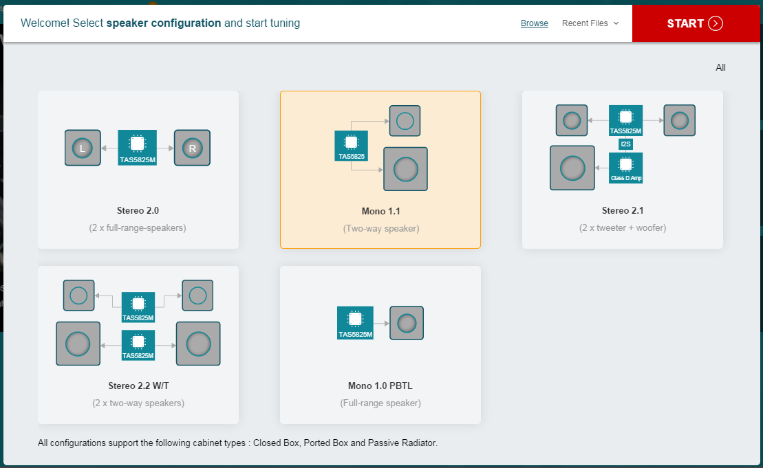

My customer have some problem with I2S clock. We use evaluation board TAS5825m and TAS5825m amplifier. Our idea is to check the different  audio system configurations.
There are two configurations:
General settings are Speaker configuration : MONO and Audio processing : SmartAmp ( 1.1 48k)
1) Other settings are default.

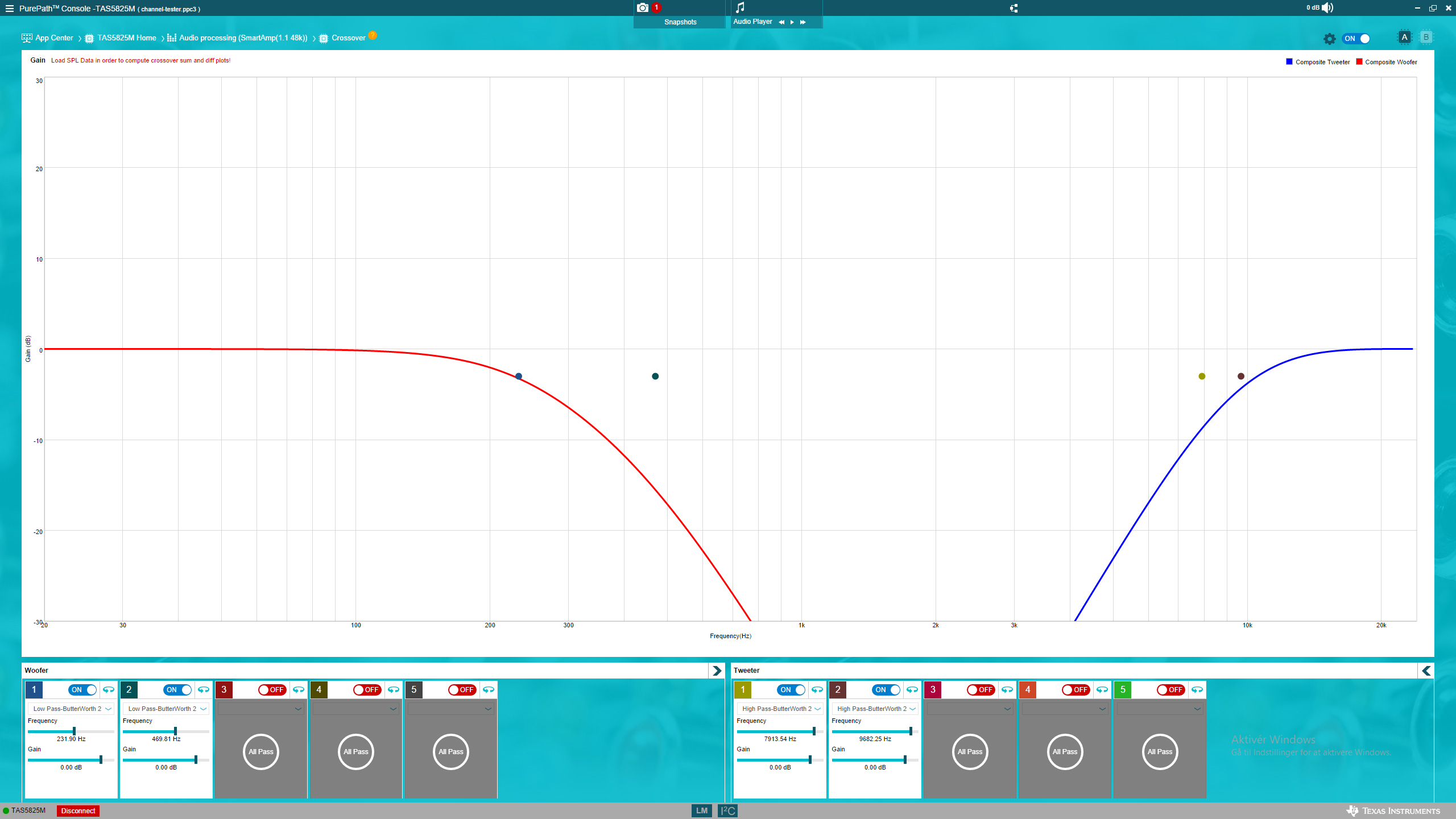

2) The main idea of second configuration is "to make it simple to verify which channel is which." This is done by having a very wide split between the crossover frequency, between two drivers. So the bass-channel rolls off at around 350Hz and the tweeter rolls off at around 9kHz. So it should be easy to identify which channel is which. And it should also be easy to identify if my code have been loaded.
With only the bass, or full-range, driver attached to either channel you should hear either really deep base, or really high treble. The level will likely be low, as there isn't much output here.
picture 1 : Speaker configuration : MONO
picture 2 : Audio processing : SmartAmp ( 1.1 48k)
picture 3: X-over looks like this ( second configuration )
Main configuration work's fine but if we use second configuration we don't have a sound and also sometimes we get error in 0x71 register with code " 0x04 "Clock error. Could you help ?

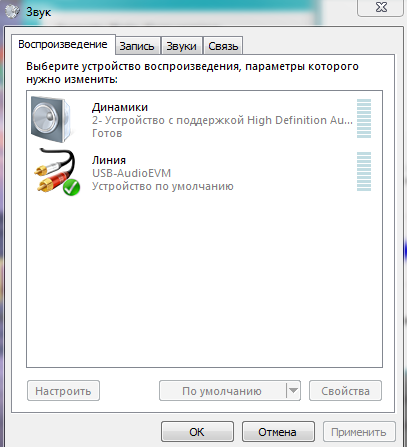

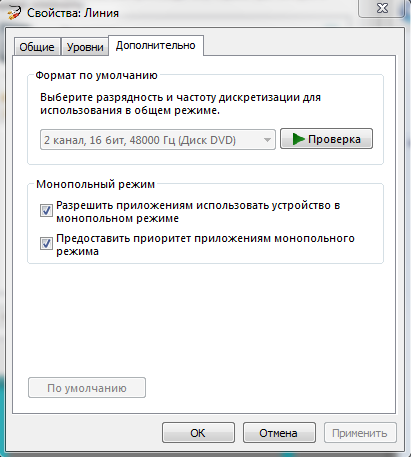

  • Hello Luis,
    I hope that next week i can send to you a waveform capture of the I2S bus.  About my Windows sound settings: I have not noticed anything strange.
    1) This picture show all sound devices.
    2 ) This picture show current sample rate. So if we use default.pcc3 setting all work's fine , and when i want to device channel - no sound.
    Sample rate: 48000
    2 channels , bit depth 16
    So, maybe i need to share something else ?

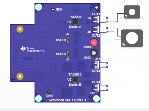

  • Hello Dmytro,
    In your PPC3 file, the audio input is configured as an optical input rather than a USB input. Is this intentional?
    Do you have an optical input connected to the PPC-CMBEVM or did you want to use USB audio.I tested the PPC3 configurations and did confirm i got audio playback and did not see faults unless the optical cable was disconnected.
     Also can you confirm that the system is connected like the image below.
    Luis
  • Hello Luis,
    You are right. Thanks for your answer , you are help to solve this problem in debug board and now we have sound.  But if it possible I have additional question about amplifier settings.

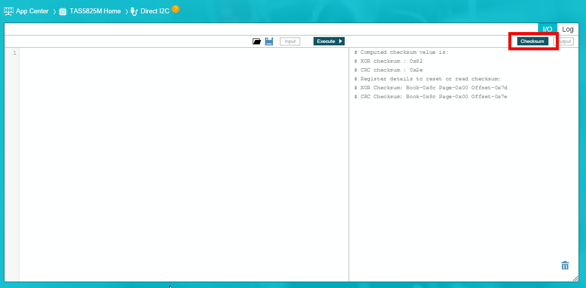

    • I2C communication could be checked through CheckSum. No need to read back all register values.

  • Hello Dmytro,
    We have a Checksum tool in the Direct I2C tab on PPC3 you see what the calculated checksum is and compare it to what you read in the register
