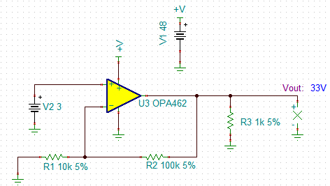

Part Number: OPA462
Hello ,
with above part number i have tasted simulation TINA software working fine but same circuit buid on hardware it shows very low output .
vcc - 48v
vee - GND
vin - 3v
gain 11
i am expecting output voltage near 40 v .

Hi Gajanan,
Per your circuit parameters, here is what I have.
If the circuit is what you have, it should expect Vout = (1+10)*3 = 33Vdc.
