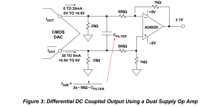

I was commenting on an old ADI app note, MT-019 Figure 3, this classic ckt is slightly off in that the impedance looking into the inverting side has an active component with a complementary DAC input.
https://www.analog.com/media/en/training-seminars/tutorials/MT-019.pdf
I noticed that the equation for alphathat I put into this section got flipped over - should have been R2/(R1+R2). This error is likely in the THS3217 data sheet as well.
To go ahead and test this result, I stepped through the sims in the attached file - this effect is definitely there often giving a mismatched load to the DAC. small effect usually, but easy to fix also.
