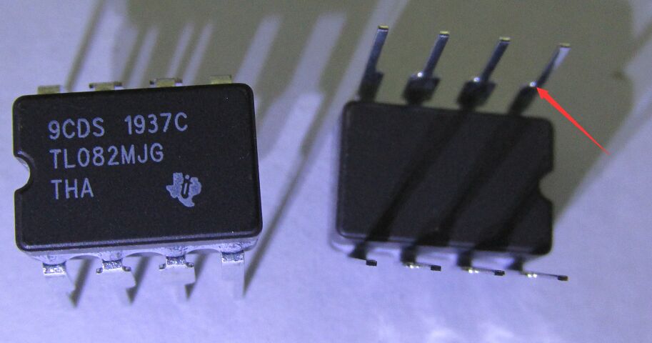

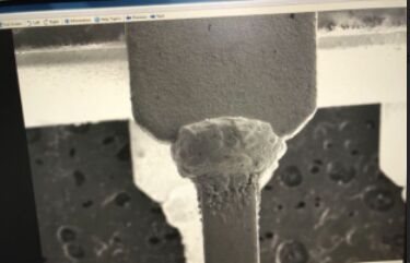

We found there seems be solder on the pin.Pls see the pictures. Can you help us confirm the part is normal or not ?

Do you have any information about how long you have had these devices and how they were stored (or used)?
The first response to come back is "parts are 100% Sn63Pb37 hot solder dip over non-plated Alloy-42 leadframe. Pins are dipped all the way to the package body." Therefore there is possibility for excess solder to be on a lead.

Kindly advise where in the process this was observed, is it at incoming or in PCB board already?
We need more photos; to see the different color on bad unit then zoom to the solder abnormal area on the pin. Use the same sample an the same pin.
