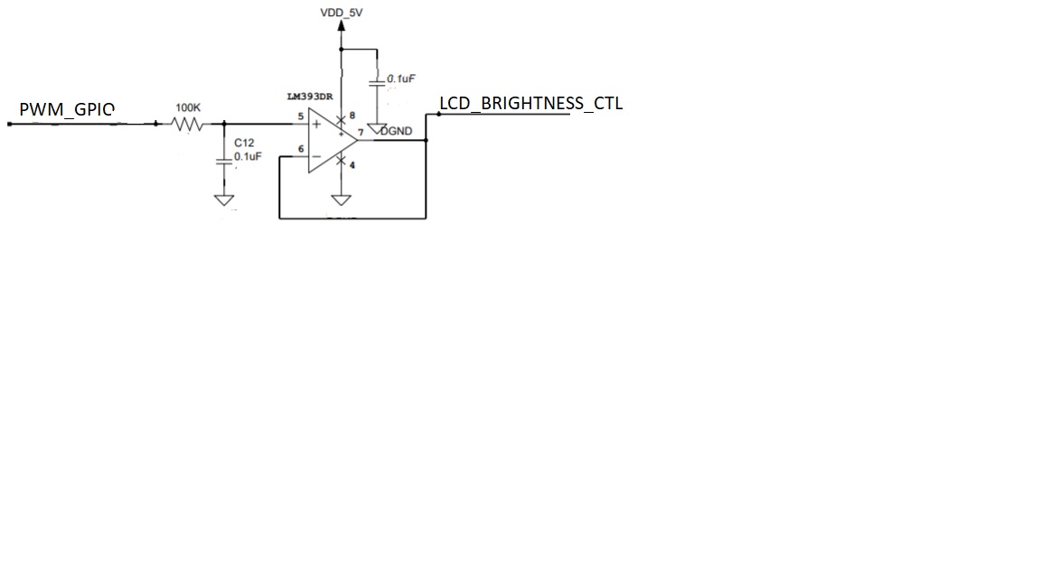

I would like to know i came across a old design that LM393D part is used for LED brightness control without pull up resistor on output.Is it possible LM393D will work without pullup resistor on output?
