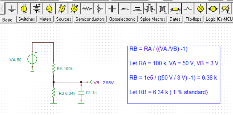

I am planning to connect E/D COM to 0 V, then I need to set E/D  between +0.8 V and +5.5 V to enable the output. Can I use a voltage divider for the same?
May I know Is it a good method to use a voltage divider in this situation because my supply is 50V.

    Yes, a simple voltage divider can be used to set the E/D pin voltage to a level that is within the +0.8 V to +5.5 V. I usually use something convenient, on the order of + 3 V to +3.3 V. Since E/D COM is being set to 0 V, then for + 3V E/D voltage it is just a simple voltage divider connected between +50 V and ground (0 V). A small capacitor can be added to the E/D pin as shown to reduce noise sensitivity, but do note is adds a short delay to the enable time during power up. This isn't usually an issue for most applications.
    • May I know Is it a good method to use a voltage divider in this situation because my supply is 50V.
    Here is how the divider is calculated. The OPA462 E/S pin draws very little current so I set RA equal to 100 kilohms.
