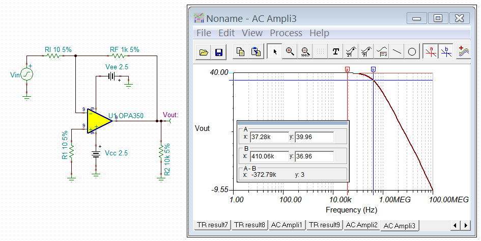

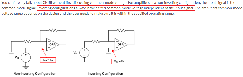

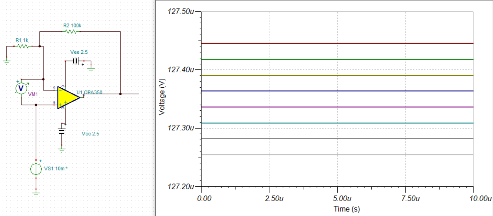

Our customer has made a test of OPA2350 to see the influence of common-mode voltage and the input offset voltage caused by CMRR. And the inverting and non-inverting configuration are shown in TINA, as below. However, there are a few problems. And we really appreciate your help.opa2350 inverting.TSCopa2350 noninverting.TSC

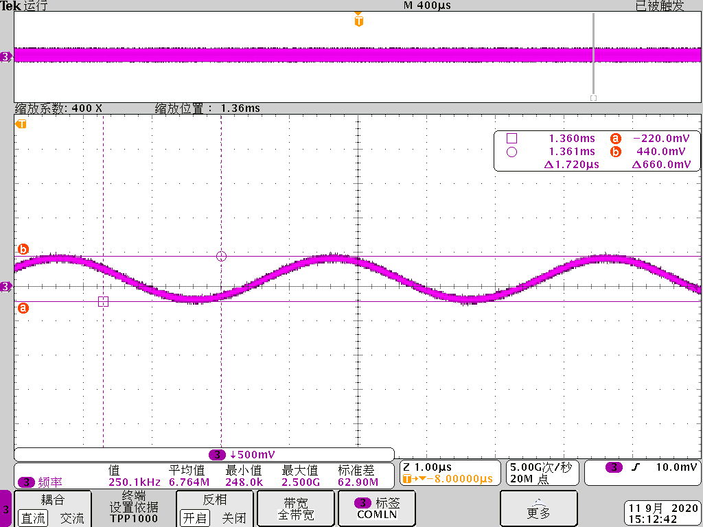

1. In non-inverting configuration, the input signal is 40mV Vpp sinusoidal signal, frequency is 250kHz and 380 kHz. The output signal is shown as below, respectively.
- Why can not the amplifier output get to ±2V?

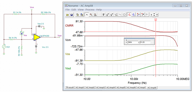

2. In inverting configuration, the input signal is also 40mV Vpp sinusoidal signal, frequency is 250kHz and 380 kHz. But the output signal is shown as below, respectively.
- Why the output is so much lower than ±2V?

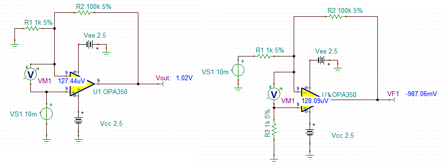

- And this time the output of 250kHz and 380kHz are the same. Is it because that inverting configuration doesn't have common-mode voltage?

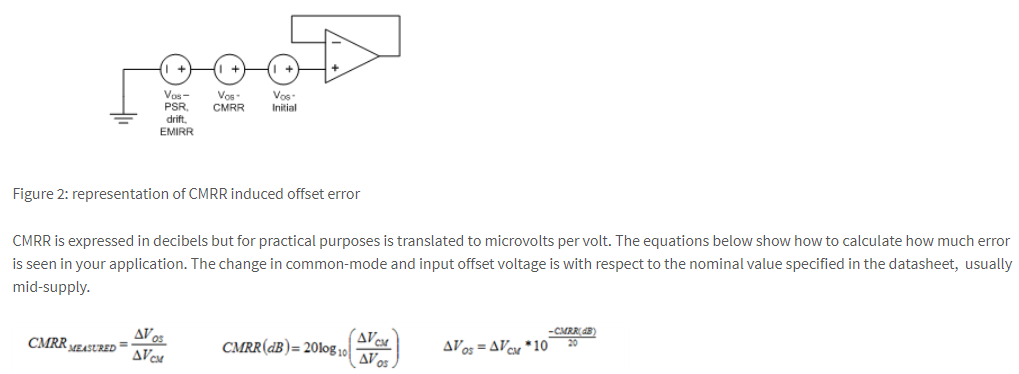

3. Is the equation below correct? Or it should be CMRR=ΔVcm/ΔVos ?

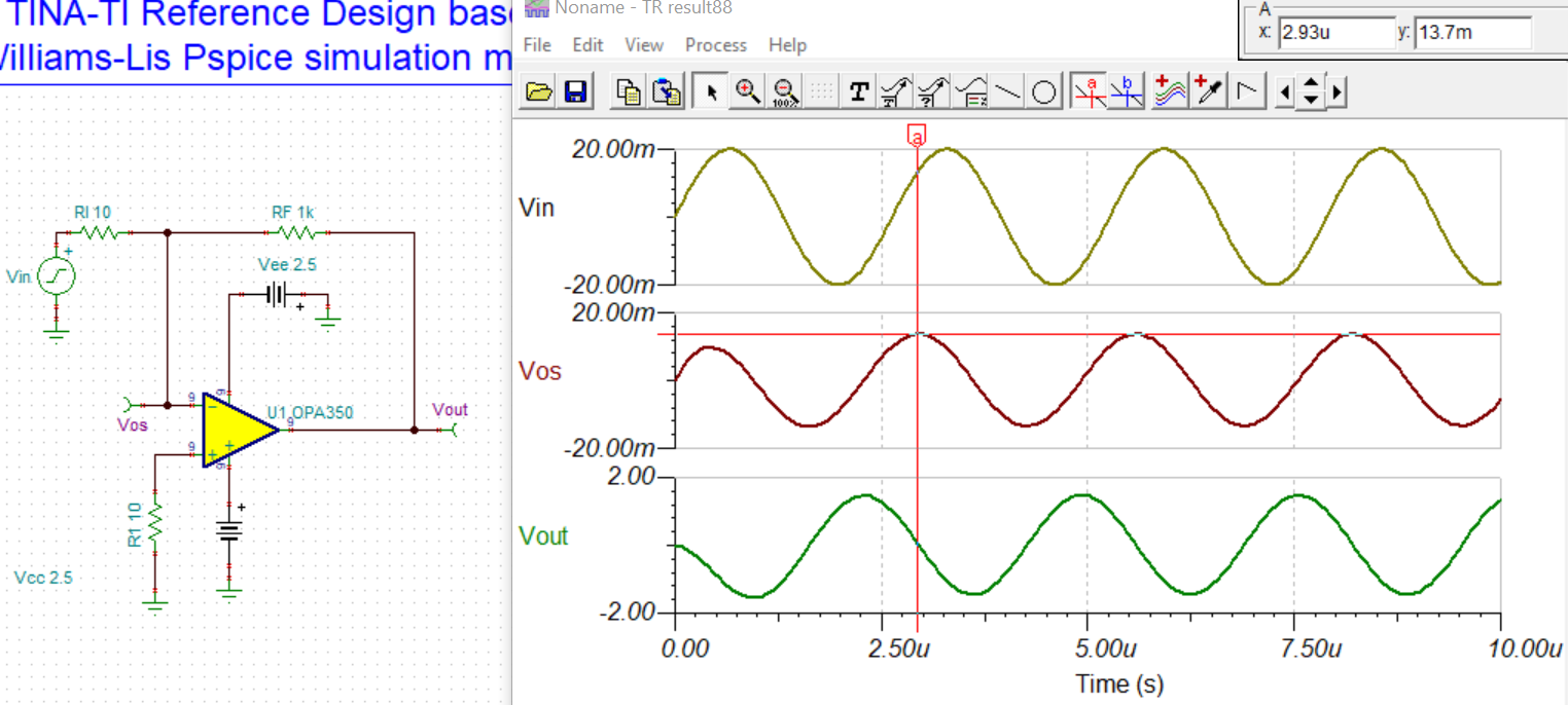

4. About CMRR, we have a question. Since CMRR is common-mode rejection, and in non-inverting configuration, the input voltage is common-mode voltage. Does it mean that the input voltage is suppressed in non-inverting configuration?
5. Using the equation below, I can calculate that in non-inverting configuration, ΔVos=20mV*10^(-52/20)=0.05 mV. But the peak value of simulation result is about 14.72 mV. Besides, in inverting configuration, ΔVos is not zero. So we got confusion here.
