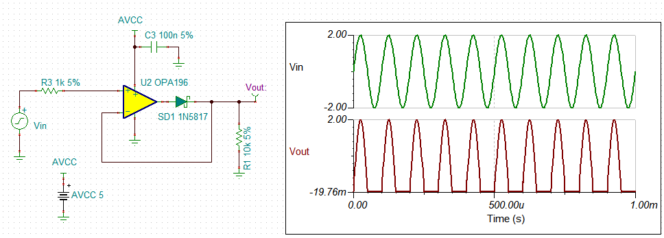

I am currently designing an absolute value circuit while looking at JAJA204.
However, if the input voltage is negative, the output voltage will not drop to 0V.
How can I reduce it to 0V?

Hi Yuzuru-san,
Do you mean that you want half rectifier like the image below?

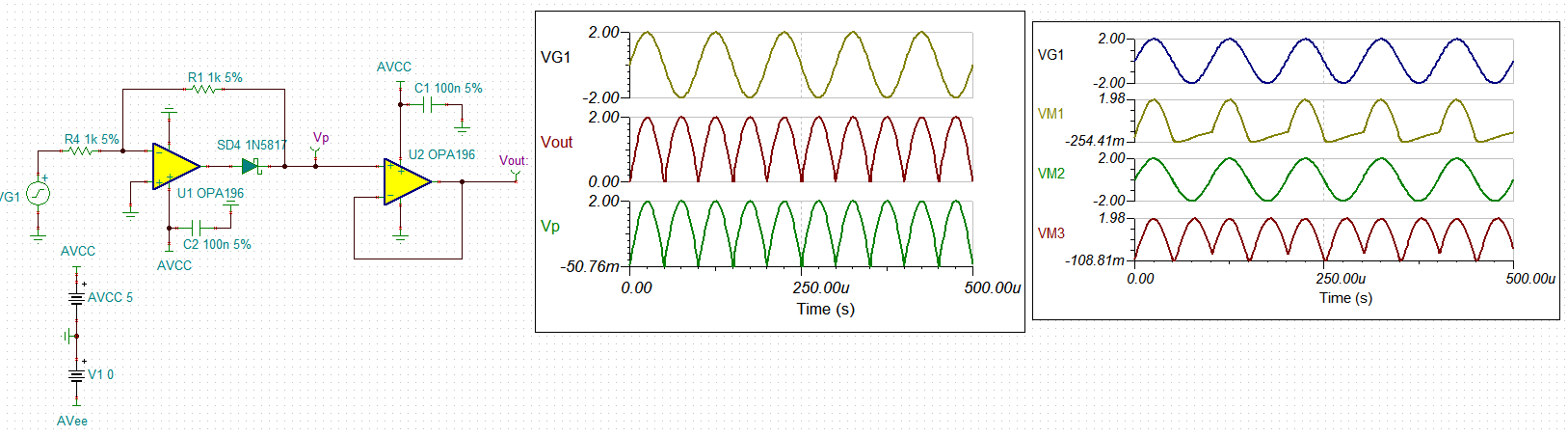

Here is the full rectifier circuit
/cfs-file/__key/communityserver-discussions-components-files/14/ABS1-E2E-full-rectifier-10152020.TSC
Or remove your -5V at OPA196

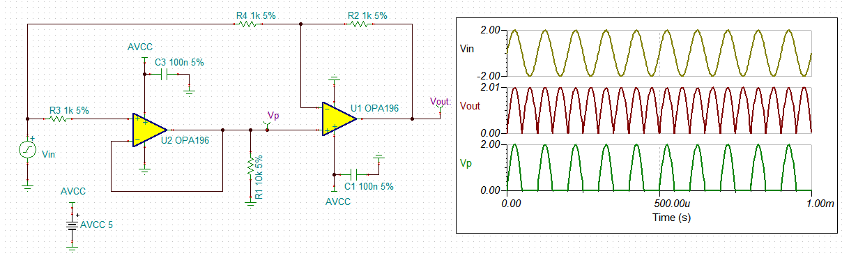

Here is a simpler one without diode for full rectification:
Please let us know if this is what you want.

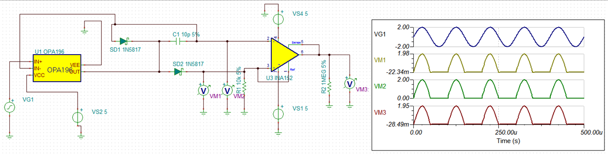

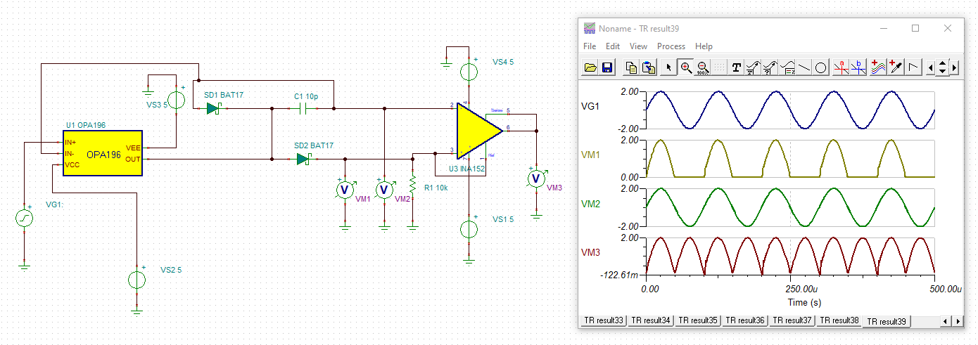

Hi Yuzuru,
it's not quite clear to me what you mean. But maybe you should take a small signal Schottky diode and not a 1A Schottky rectifier:

Hi, Raymond
Sorry for my inadequate explanation.
Your circuits is my intention.
Thank you for your kind reply.
