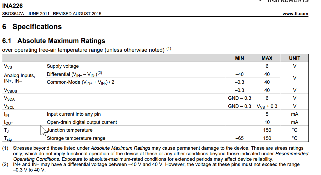

3. If the circuit is short, the transient current will be large, then the sensing voltage will exceed the max 81.9mV.  Does this will damage IC?
And if I set the Alert by 80mV, the Alert will be asserted, means the Alert Pin output from high to low?  Can this Alert do some protection for IC?

    3)  Look like differential you can go upto 40V.  Please see Absolute Maximum Ratings.  Recall these are not functional ranges but absolute maximum that part can with stand.  also pleas see note (2)
