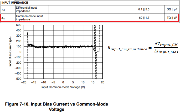

    We do not have metrological characterization of the OPA189 impedance beyond the typical 25 C information provided in the Electrical Characterization table. With the differential and common-mode resistances so high and capacitances so low these usually aren't a significant factor affecting the op amp circuit precision.
    About the best indicator of the input impedance changing with temperature is the input bias current slope seen in the OPA189 datasheet Figure 7-11, Input Bias Current and Offset vs Temperature. We can see from the graph that the slope increases when the temperature exceeds about 100 C indicating the input real part of the input impedance is decreasing. This is due to the normal leakage current of the input ESD diodes increasing with temperature. You can see how the input bias current behaves with input common-mode voltage in Figure 7-10.

    Here is the a method to check for the input impedance. In OPA189, the input Rcm is so high, it is nearly a constant vs. input Vcm.

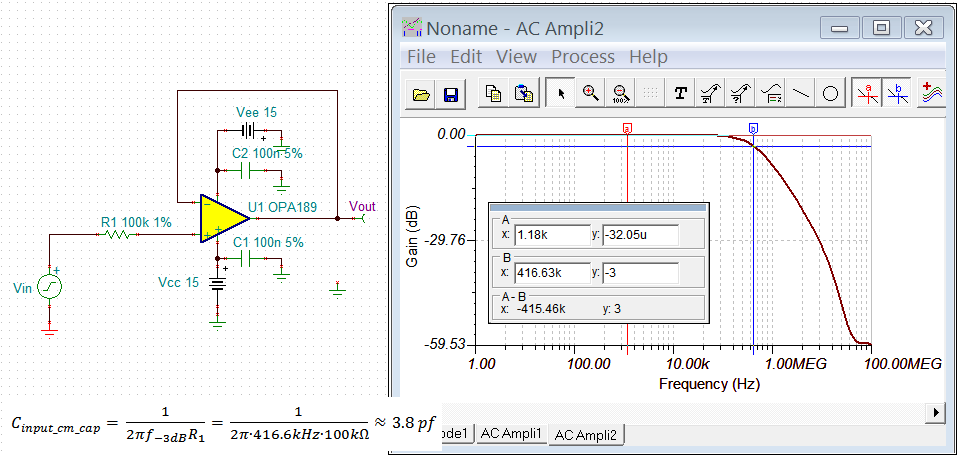

    The input Ccm can be calculated in a following method. First, determine the -3dB frequency with the following circuit, Then, back calculate the input Ccm.
    I do not see the Ccm vs. temperature in the datasheet, but you may be able to compare the setup for 25C and/or an elevated temperature, and see its dependency in a given configuration. Ccm is shown approx 1.7 pF at 25C in the datasheet.  The simulation is estimated approx at 3.8pF. Ccm in 1.7pF is measured figure at 25C according to the circuit configuration presented in the datasheet.
    The -3dB point with R1=0  in the buffer circuit is approx. 18 MHz.
