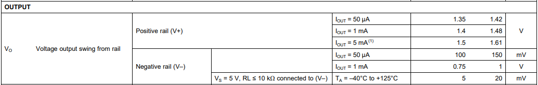

We are promoting LM2904B-Q1, and some questions about LM2904B-Q1 output swing from rail spec need to check with you.
1. In datasheet, LM2904B-Q1 output swing spec is shown below. For Vs=5V, Iout=1mA, TA=25C application, is the maximum output voltage (5V-1.4V)=3.6V typical?

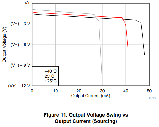

Also in datasheet figure 11, the swing to rail voltage did not vary too much vs. temperature, like (5V-1.5V)=3.5V typical.

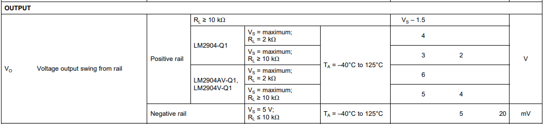

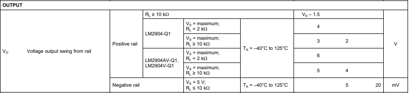

2. For LM2904-Q1 spec below, for Vs=5V, RL=10k, TA=25C application, is the maximum output voltage (5V-1.5V)=3.5V typical?
And considering -40C-125C range, the maximum output voltage should be (5V-3V)=2V typical?
