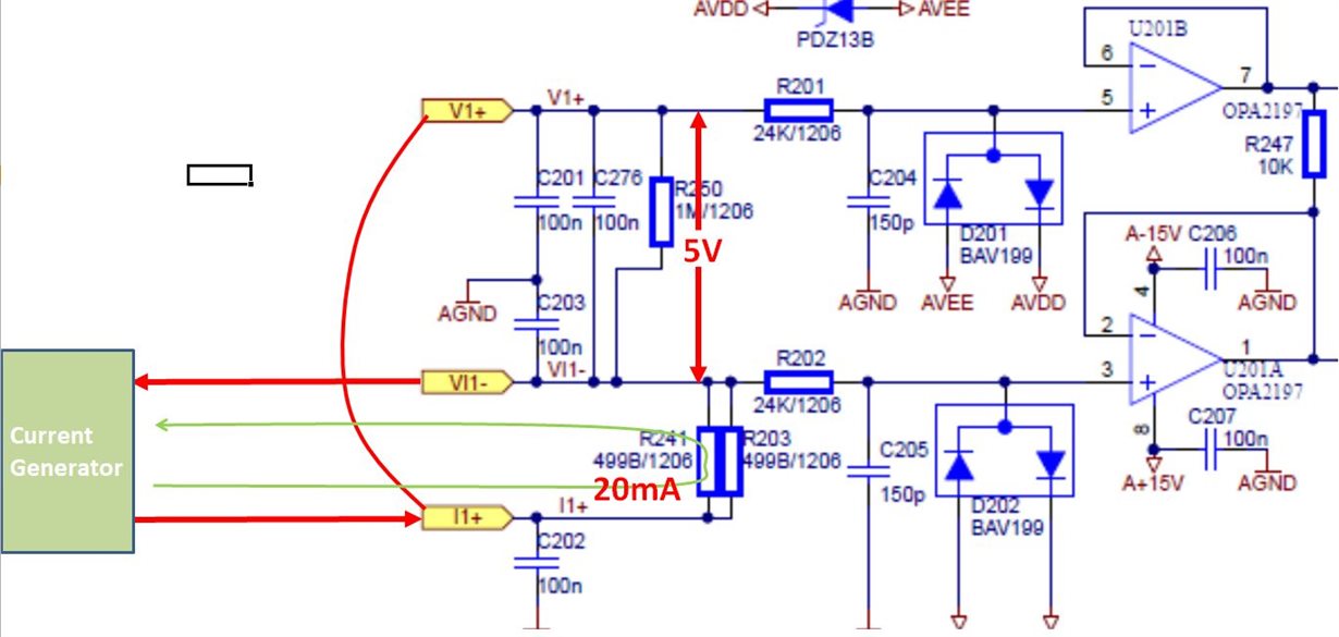

My customer encounter THS4551 output offset issue when doing ESD test on this board. Below is customer’s SCH and it is for PLC AI application.
In current input mode, V1+ and I1+ are short together then input 20mA current on this terminal. 20mA flows through R241//R203(about 250ohm) to VI1- terminal that create a 5V differential voltage on the OPA2197’s IN+(pin 3 and pin5 of U201). The output voltage of OPA2197 is 5V as well(measured at both side of R247). Meanwhile, THS4551’s differential output voltage is 1.78V, measured at IN+, IN- (both side of C210).
Performing ESD test, +6KV on V1+ terminal 5 times, THS4551 differential output votage increased to about 3.7V. OPA2197 differential output voltage dreased to 4.53V, but input voltage of OPA2197 didn’t change that remained at 5V.
All devices didn’t get damaged, the offset error was gone when power off and power on whole system. Custoemr would like to know why THS4551 has large output error when it is experienced ESD test. Could team help to provide comment or suggest us any exeriments we can do to investigate this problem. Please let me know if you need any information.
