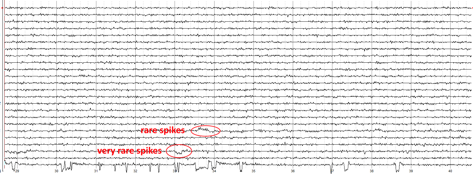

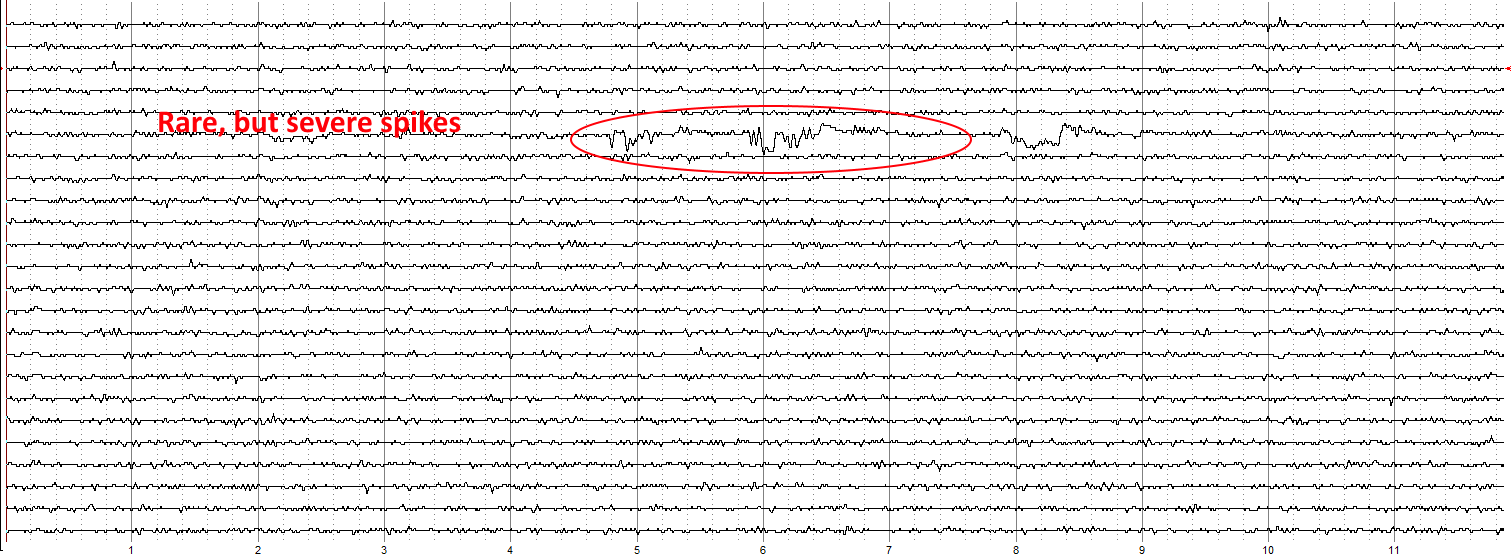

Hi everybody,
We are developing biopotential measurement system (EEG) and have an issue with some OPA4141 chips demonstrating popcorn noise signal. In the last batch we have 21 chips total, one with sever popcorn noise and two demonstrating rare spikes (several spikes per minute).
The most annoying problem is with that chips with rare spikes, because it is very hard to test them, it tooks very long time, and still there is no certainty that consumer will have absolutely popcorn-free device.
I`m absolutely sure, that it is not pcb, soldering, EMI or aquistition artifacts - we tried to resolder particular bad chips on different pcbs and on different channels (every pcb has seven OPA4141 channels), manualy resoldering with lowest possible temperature, with most passive flux such as CF-10, cleaning bord in ultrasonic bath - problem still stay with particular chip. Also there was no such problems with different op amp (max4478, also JFET, but with higher noise, 10 years in operation, about 700 pieces)
We also observed the same problems with OPA4140, OPA140, but there was less statistics, so we thought may be it was just a "bad batch".
We are really like OPAx141 for it low 1/f voltage noise and almost no current noise, perfectly suited for biopotential measurement systems but popcorn noise problem zeroing this advantages.
Is there any hope that this situation can be improved in future?
