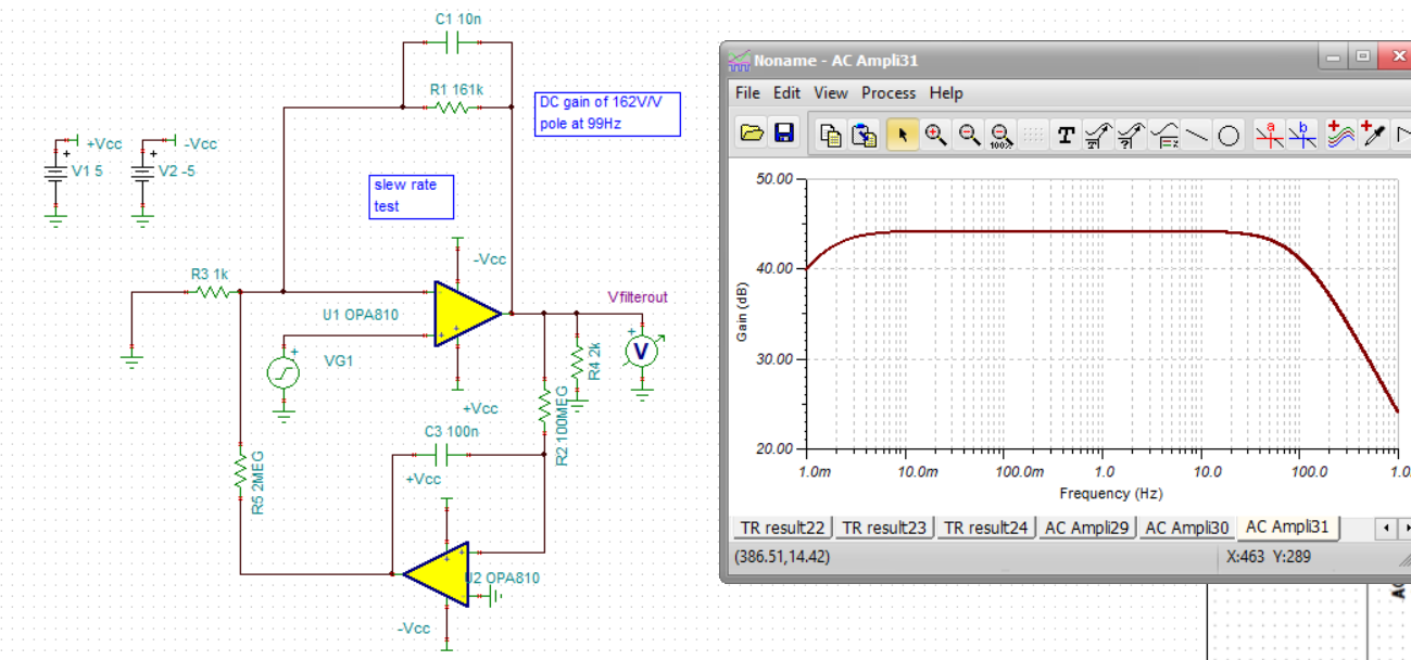

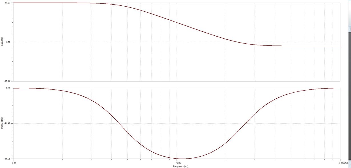

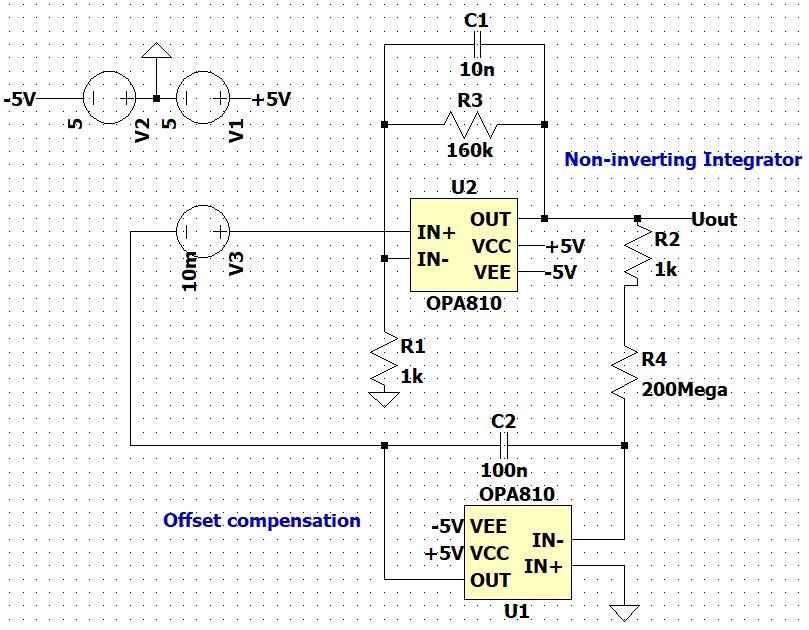

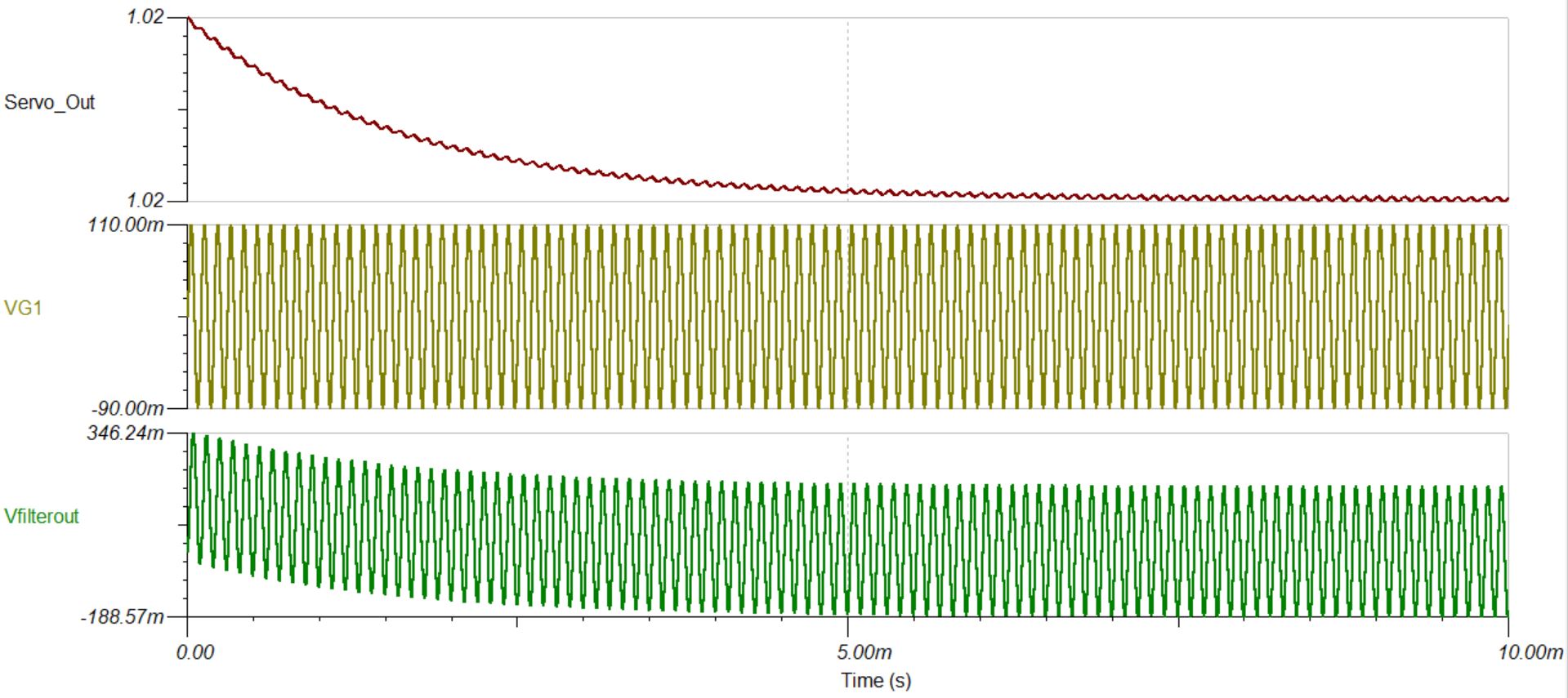

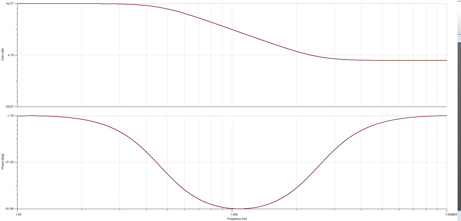

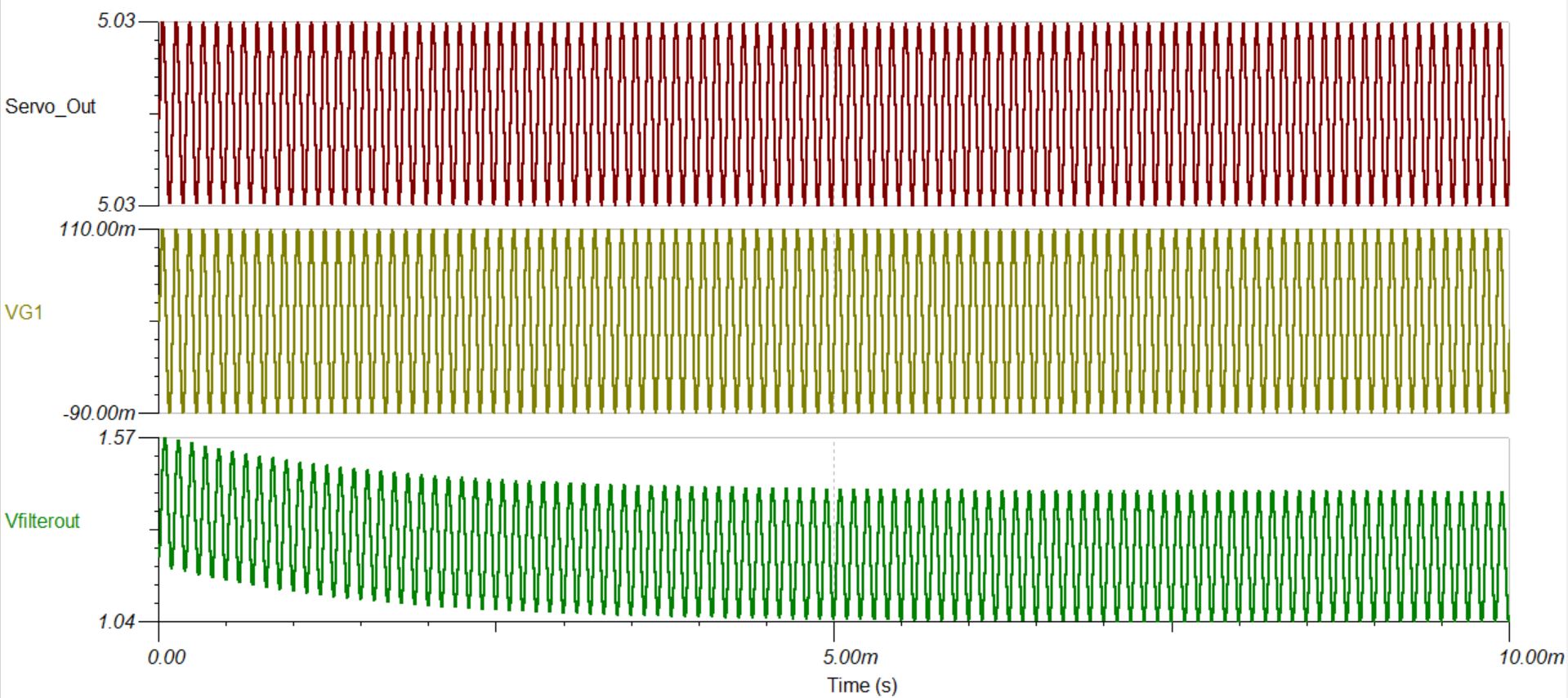

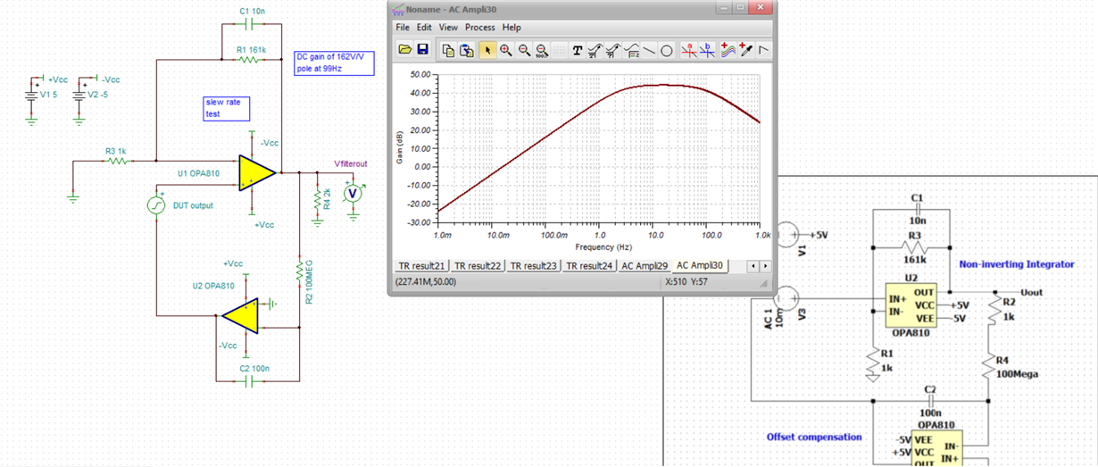

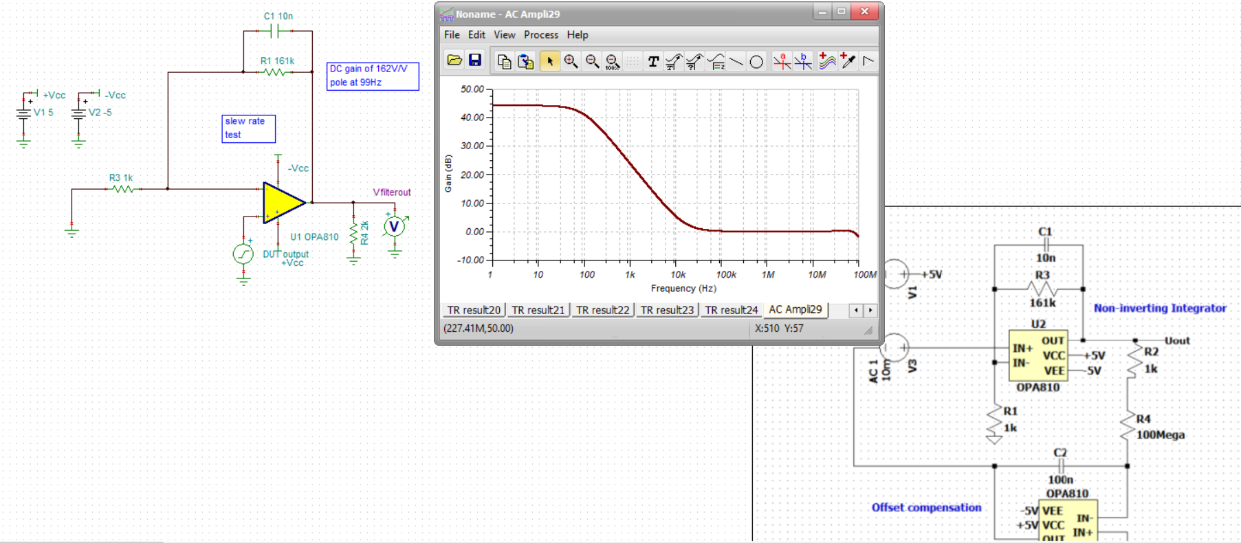

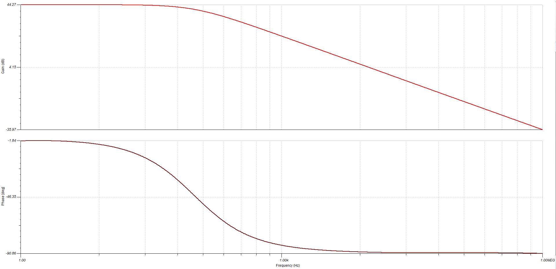

Hi all,
i have a question regarding the external circuit of the OPA810 amplifier.
I want to built a non-inverting integrator with offset compensation. The corner frequencys for the integration range is 100 Hz to 16 kHz. In addition i wanna have an offset compensation, because the signal i want to integrate maybe have an offset. For that i simulated a circuit, but i don't know if the OPA810 can deal with my external resistors and capacitors. Im espacially afraid of the Resistor R4=200M and the Capacitor C2=100n. Do you think/know this will be a problem for the OPA810. By the way do you think the OPA810 can deal with the other components to? You can find the simulated circuit in the attachment.
I hope you can help me and i am really thankfull for every tip from you.
