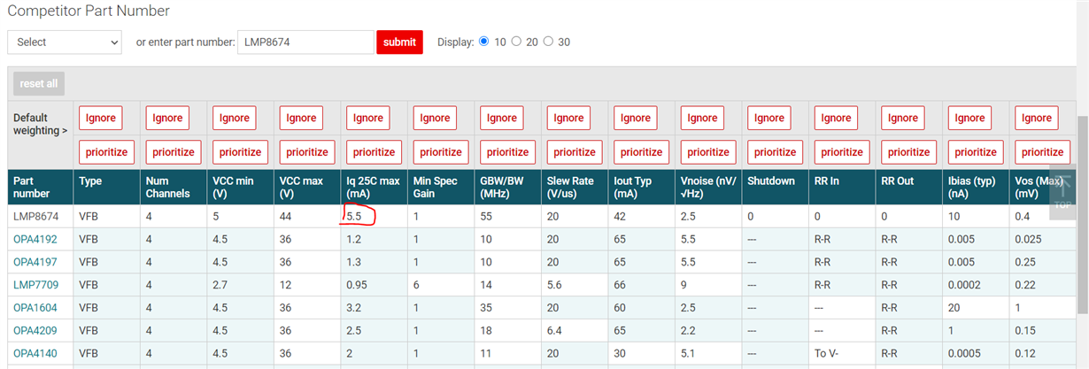

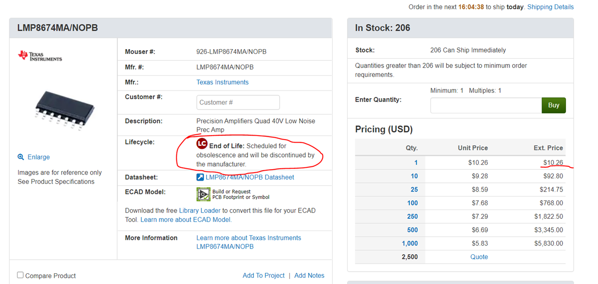

  • Morning Seijiro-san,
    It appears to be going away - here is the Digi-key page for it,
    Not sure why, but one issue might be that 5.5mA quiescent - if you actually operated this quad at 44V total supply, that is almost 1W quiescent power, here are some options,
