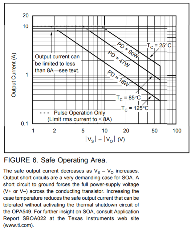

Hi team,
I found in datasheet that, when supply voltage is 5V beyond output voltage, OPA549 can output continuous 8A current. However, I just measured below maxim current (Io). Beyond these current, output voltage (Vo) will drop.   V+ and V- are the supply voltage, I+ and I- are the measured current of supply. RL is load and Vin is the input of OPA549.
Is this because of the thermal protection? Is there any other thing that I could have a check?
Thanks.

    for the last entry in your table the OPA549 has to dissipate:
    (10V - 4.54V) x 6.47A = 35.3W
    This is quite a lot. Higher output currents are only available with a proper heatsink providing a theta of better than 1.4°C/W:
    (1.4°C/W + 1.4°C/W) x 35.3W = 99°C = (125°C - 26°C)
    where 125°C is the recommended maximum junction temperature of OPA549 over long periods, 26°C is the temperature of ambient and 1.4°C/W is the junction to case thermal resistance of OPA549.
    So yes, without such a heatsink the built-in thermal protection of OPA549 which provides a very helpful SOA protection (safe operating area) will prevent higher output currents.
    All this is very nicely discussed in the datasheet, by the way :-)

  • Hi Jerry,
    As Kai pointed out, these Safe Operating Area of OPA549 is discussed on p. 10 of the datasheet, see the attached image.
    You need also check the case temperature. Enclosed is the heat sink mounting requirements.
    /cfs-file/__key/communityserver-discussions-components-files/14/2500.OPA549-Mounting-Recommendations.pdf
    If you have additional questions, please let us know.
