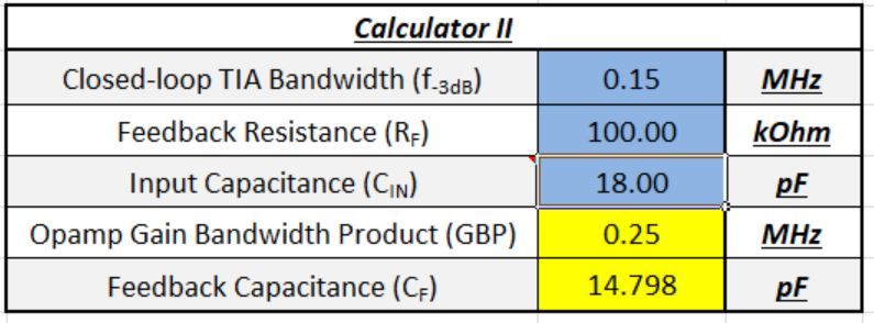

  • Hello Hasan,
    The customer will use between 80 KHz and 150 KHz frequencies. GBP of the TIA will be 1.6 GHz.
    The duty cycle rate will be between 0.1% and 1%. Also could you explain what you mean “additional filtering” for TIA?
    Thanks!
    Art
  • Hello Art,
    The devices you are looking at are way above the requirements needed to build this trans-impedance circuit. Note that the transimpedance gain doesn't determine the GBP of the amplifier but rather the noise gain of the circuit (which is mostly shaped by your input and feedback capacitors). You can use this calculator to figure out your amplifier requirements.
    Note that this calculator uses the assumption that Cin >> CF, so results may seem a little off for this specific use case. This can be fixed if we increase your TIA gain further as i've done below. But the main thing to note here is that these requirements can be achieved with an amplifier that has a GBP < 1MHz.
    By additional filtering I just meant adding an additional low pass filter following your TIA circuit.
