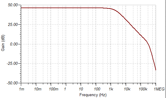

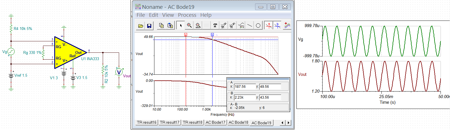

I want to create a schematic with the ina333 and try to simulate it. But the output properties do not behave as expected.
I'm using a single 3V supply with a 1.5V reference voltage and tired different gains G = 1 + (100 kΩ / RG) with RG = [1k, 500, 330]
The resulting bode plots look like this:
for RG=330
for RG=500
and for RG=1000 no operating point was found.
Can you explain the behavior?
