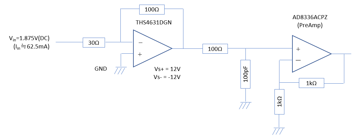

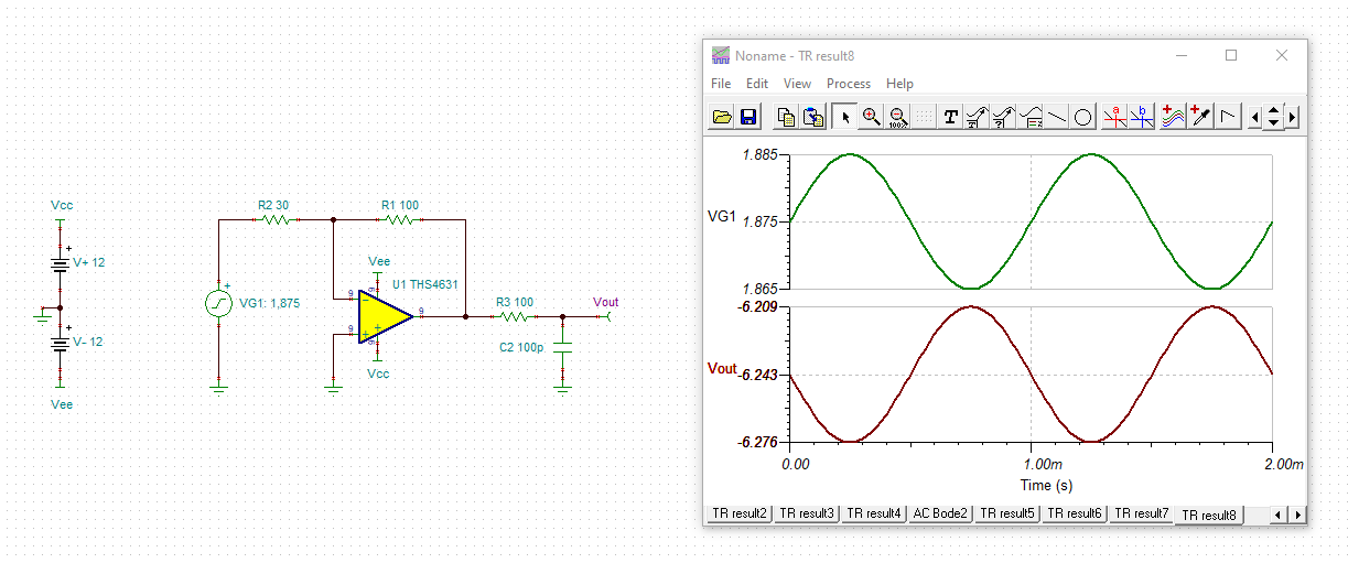

Evaluation is performed under the conditions shown in the figure below.
At this time, the-side (2pin) does not become 0V.
In other words, the imaginary short does not hold.
This device recognizes that it can flow up to 95mA, but could you please tell me the cause of this?
