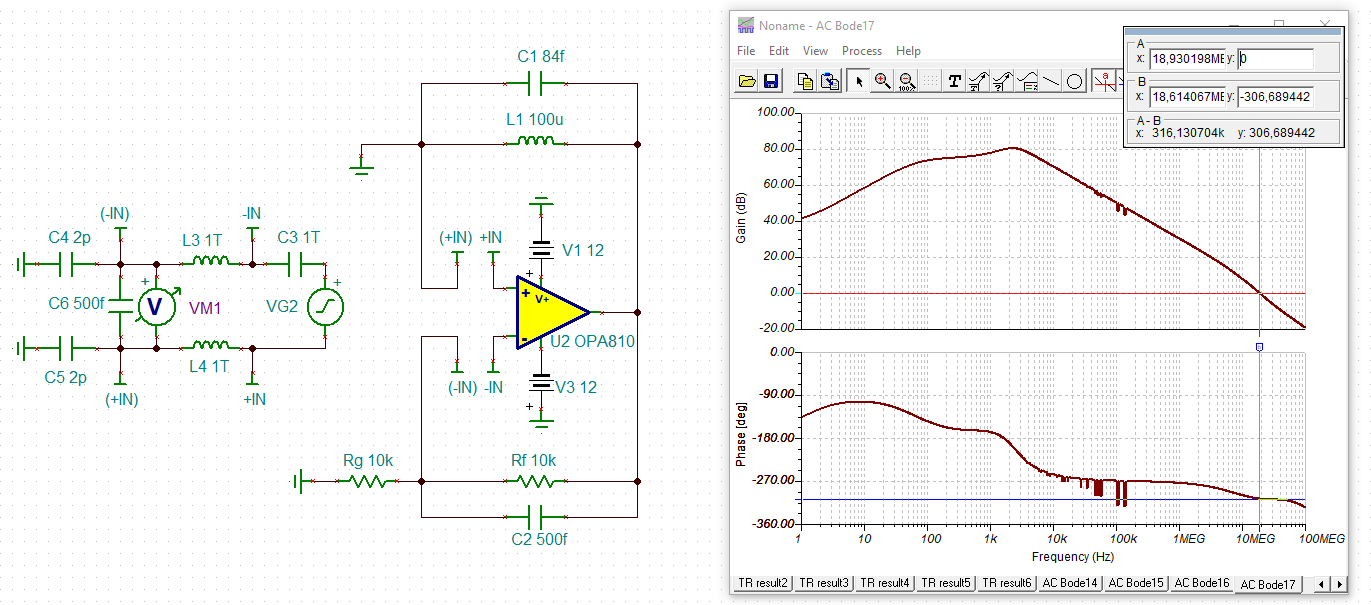

We are designing an 'Negative impedance converter (NIC)' circuit to realize an negative inductance for an EMI filter application.
To achieve the desirable negative inductance two of the methods were proposed in Wikipedia using operational amplifier.
I would like to analyze the stability of the NIC circuit with OP-AMP. I referred all TI Videos & documents related to OP-AMP stability based on Rate of closure technique. It is more helpful.
In these stability papers an 1TH inductor and capacitor is added for analysis, but for an NIC circuit the opamp is connected to both negative feedback as well as positive feedback.
Following are the list of calrifications/solutions needed on simulating NIC stabiltiy analysis.
a) I am expecting my op-amp to remain stable till 25MHz, but I hope the presence of inductor will affect the stablity. How to analyze it.
b) Whether It is better to go with an inductor in an OPAMP circuit or an alternate circuit using capacitor which mimic as negative inductance (Please refer Wikipedia for Circuit details)
c) How to make an NIC circuit to remain stable till or above 25MHz.
d) How to measure open loop gain for NIC circuit having both positive and negative feedback circuit

    For circuits with both positive and negative feedback paths, you will need to apply a different analysis but the general method is the same.  Consider the generic op amp block as with two feedback loops, solve the transfer function, and find the condition in which the closed loop gain is undefined.  I will spoil the surprise and let you know that the critical point is, just like for negative feedback circuits, where Aol * Beta is equal to -1.
    Of course, we'd rather not have you reinvent the wheel.  Please see this post here and scroll down to the bottom.  You'll find a presentation titled, "Dual FB Beta_plus and Beta_minus RevD.pptx".  Download the file and you will find just the calculations showing you how this is derived.  Starting on page 13, you can see the generic circuit to set up to test the stability.  Build this circuit in simulation, place 3 extra capacitors to mimic the input capacitance of the op amp, and run an AC test.  Vfb will give you AolBeta.  So, that's the key signal to get your phase margin.
    This presentation should answer both questions a) and d).  Let me know if you need any help.
    For question b), it looks like the wikipedia page suggests capacitors.  For most smaller applications, inductors are avoided.  I am assuming you mean in real life.  If in simulation, use the inductors to help you test for stability.  For question c), I would use the same techniques as described in TI precision labs.  I can help you with these as well if you decide your circuit is not stable.

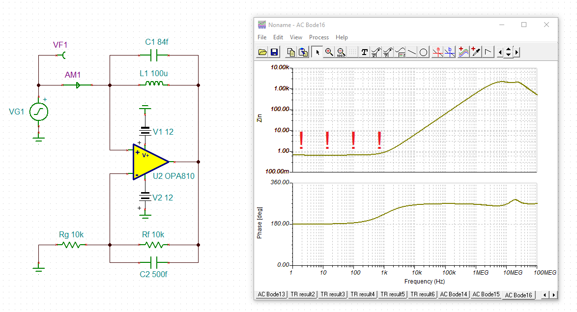

  •        Circuit showed in figure is negative impedance converter where 'Z' mentioned in figure is inductor
  • Hello Ajith
    The inductor will be problematic because there can be no DC solution.
    Swap Z with the feedback R1 resistor. Make Z a capacitor.
    Z = -j*2*pi*F*C*R1*R1 per a wikipedia.org formula (I have not verified this)

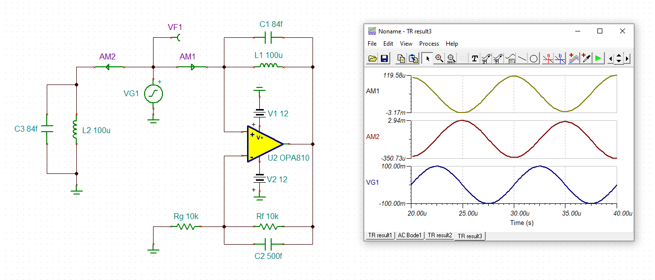

  • And the proof that it's a negative inductance:
    Kai

    Thanks for suggestion, I had gone through the slides it's useful for my analysis, 'Dual feedback stability analysis' referred has the feedback in both inverting and non inverting terminals as ratio of impedance
    Refer NIC circuit below constructed using capacitors and resistors in feedback
    In this circuit the Resistor R1 in positive feedback is acting alone, while R1 and C in negative feedback acts together. In general for AC analysis sources to be grounded hence if input in non inverting to be grounded, R1 in positive feedback will acts as the load. In this case positive feedback don't come in the picture.

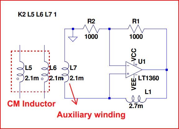

  • Hi Kai,
    As requested, Please refer the below circuit.
    L5, L6 are the common mode inductor and L7 is the auxiliary winding for sensing the common mode current.
    In General, negative inductance circuit is mostly used for parasitic cancellation and impedance boosting applications.
    In the below circuit, op-amp based negative inductance circuit is used for boosting the common mode inductance. Thereby size & volume of the CM inductor shall be reduced.
    a) The inductor in feedback path will be problematic at low frequencies but the effect of CM noise mostly occur between few KHz to few MHz. In such case whether can i go with this method or i can switch to NIC with capacitor feedback circuit.
