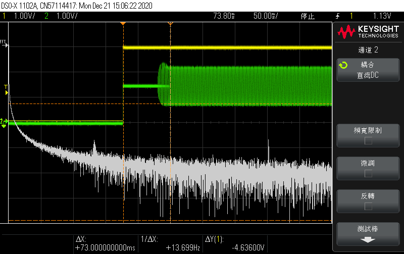

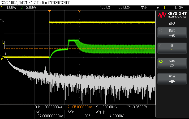

We need to quickly switch the amplifier's power supply. But we found that the amplifier output signal will have a delay, about 84ms (secondary amplification)
Do you have an amplifier or other design that can respond quickly?

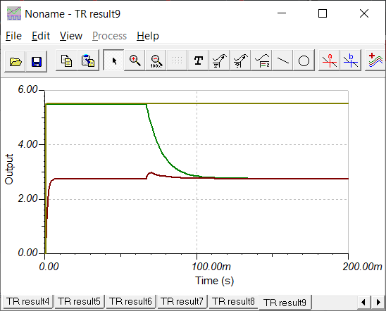

Hi Ping,
I think the delay comes from the time constant formed by (R5 + R7) x C6 = 35ms (worst case) and not from the OPAmp itself.
Kai
After running a quick simulation, Kai (once again) is correct. Running the worst case sim in TINA (file attached) lowering the capacitor value from 1u to 10n greatly speeds up the response.
