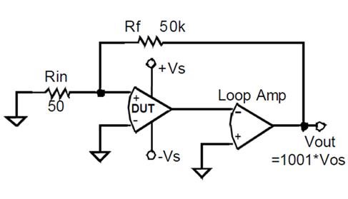

Hi team,
My customer wonder use our part to replace the ADA4077, but his component test team highlight our part have gap and failed this test cannot to directly to change.
The test is
Following the picture is his Voffset setting test condition , our gap is the secondary output will ringing , but competitor will not to see.
I try to change the Rf value to bigger and lower even add the RC on secondary amps output , but it still have no any help to fix.
I know this setting seems not really for Voffest checking , but our customer  wonder to keep this setting to test the Voffset.
Because if we wonder to replace ADI , we also need to pass this setting condition is fair and the same level to compare performance.
Could you have any idea can share for me to turning in this case to fix it ?
