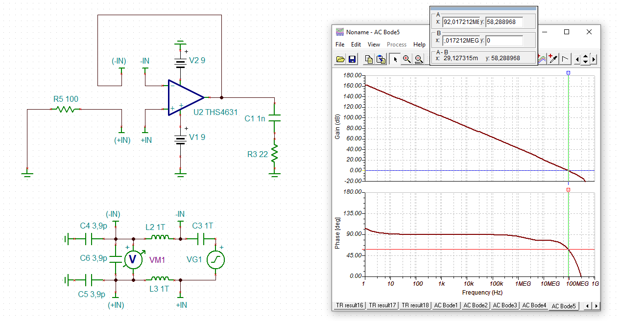

Dear Ti expert,
I consulted you a problem about the configuration of peak detector several months ago.
e2e.ti.com/.../940064
I followed the circuit shown by Kai in the thread above, and it worked perfectly.

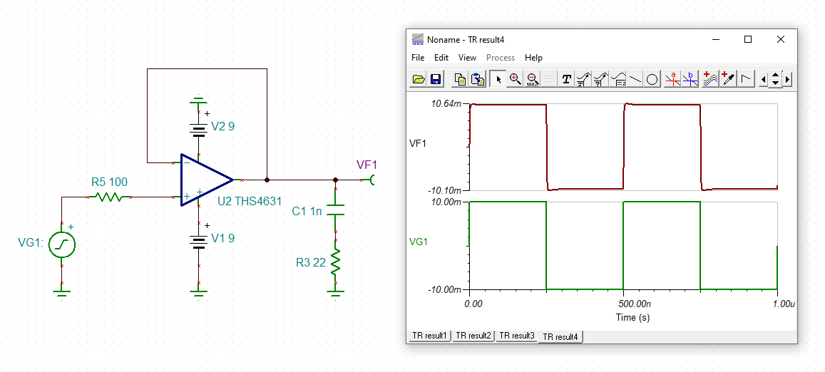

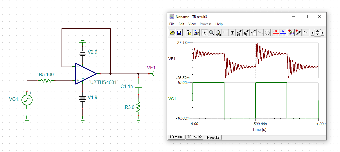

When I remove the R3 in the circuit proposed by Kai in the thread above, the output willl obviously oscillate a bit and deviate from the input when the input rises. This happend in both simulations and experiments.
I wonder why this R3 is so important?
Best Regards
