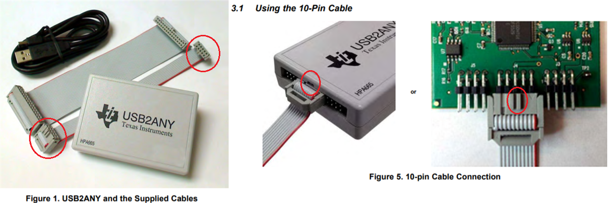

Please share the cable connector part number and Suggest the male connector part with key for PCB.

Hi Dharma,
You are able to find the equivalent part via amazon.com. Or you can buy the IDC header connector header kit and flat ribbon cable to make you own. I did not see the specific part number in the user guide.
If you have the IDC header and correct pitch flat ribbon cable, you may make your own. You need to line-up pin1 of cable indicator (colored indicator wire as shown below) with pin1 of IDC header, you may use vise or suitable clamp tool to squeeze cables into the contact pins of the IDC header. It is really easy to make if you have the components.

Once again, we need suitable mating connector for TI shipped 10-pin IDC type female connector to place it on PCB.
Any idea on male connector part, becoz TI shipped 10pin connector having KEY, it should perfectly mate to board male header to avoid discontinuity.

Hi Dharma,
These are standard IDC connectors. From the image below, the KEY is only shown on the enclosure itself, not on the PCB (Even PCB has male connector socket, it should still work fine). KEY is direct the user for the orientation of the cable or pin 1. 0.050" pitch will make the connection. As long as you have the connector has the correct pitch in 10-pin female connector, it will fit.

I am unable to find specific part number for the ribbon cable in our site. Here is the one listed through mouser.com.
There is nothing special about the IDC ribbon cable. It is approx. 6-8" in length. These are standard IDC header with 0.050" pitch size. The same pitch size and pin header counts of the ribbon cable are interchangeable.
