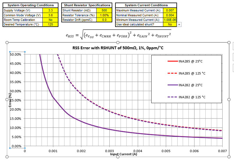

    A schematic would indeed help confirm what's going on. When you say 50mV of "noise," is the output still roughly stable, just 50mV off the expected value, or is there actually 50mVpp of noise centered on the correct value? Either of these conditions could be explained by the graph below, but what's most likely occurring here is that additional offset is being generated at the shunt due to increased input bias current. Can you share the following:
    - What size shunt are you using?
    - What magnitude of current are you measuring?
    - What is the voltage magnitude of the signal measured directly at the pins of the INA185 (not across the shunt), and what is the corresponding output voltage?
    In current shunt amplifiers, when the the common mode of the load line exceeds the magnitude of the supply voltage, the device switches internally to a different input network that is capable of level shifting the higher voltage being measured. This comes with the tradeoff of increased input bias currents at the inputs, of which the current into IN- will flow over the shunt resistor and create an additional input offset voltage. This data is shown in figure 7 of the datasheet:
    It's a tough curve to interpolate, but you can see at 3.3V, you are operating right on the step of the curve such that when your reach the condition you're describing where the voltage of your load line becomes >Vs, you are adding 25-30uA of current through the shunt, and therefore an additional 30uA*RShunt in offset voltage to the input pins of the device.

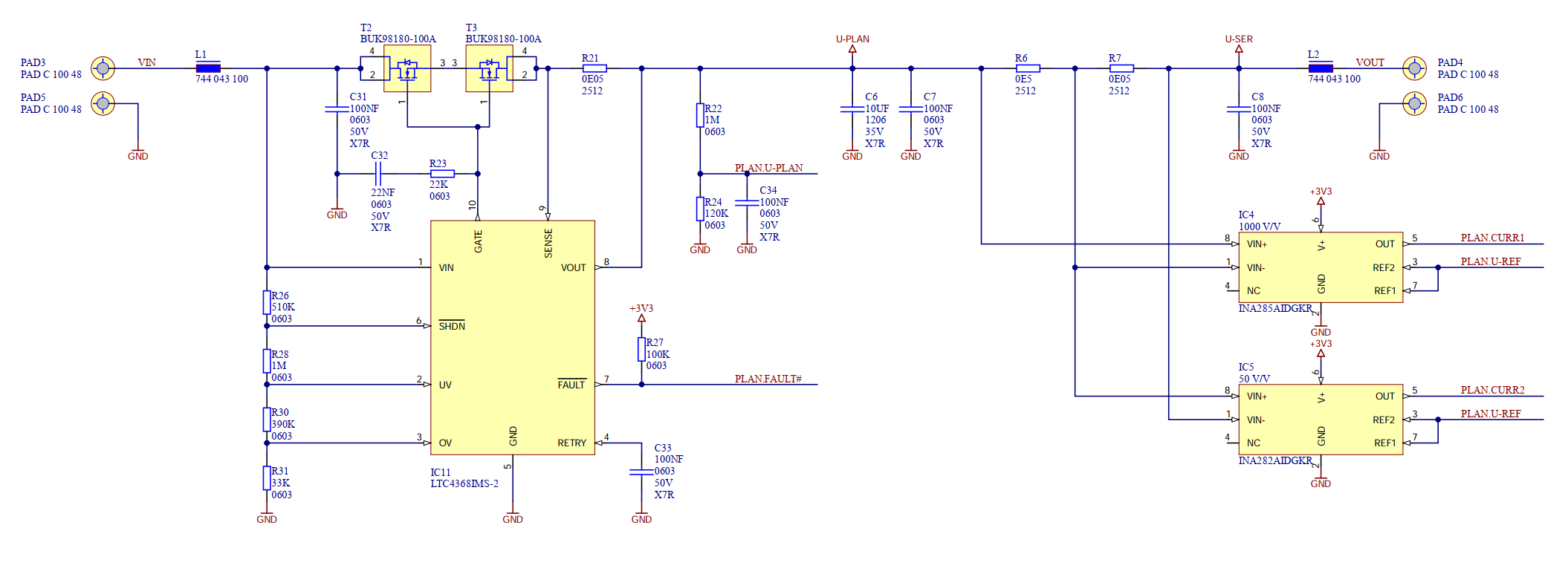

    Here you can see the schematic.
    PLAN.U-REF is connected to GND. Shunt for meassuring current in uA range is 0.5 Ohm.

  • OK, here is the part of the schematic:
    As I wrote last time, I think that the switches which shown in the block diagram on the first page of the data sheet will influence the measurement.

    The bias curves are not affected by the switching input network with enough magnitude that it would cause this much error on the output. Working backward from your output, a 50mVpp (+/-25mV) signal indicates that you are seeing roughly a fluctuating +/-50uA on the measurement line (25mV/1000/500mΩ) of the input. This is the only condition that changes as you reach the condition of VCM > Vs. Can you probe the output voltage with an oscilloscope to see the noise here, corresponding with the input waveform of the shunt voltage?
    The other explanation is that it could be error in the system. Now that I have a better picture of what is happening here, the other major issue here is the magnitude of the current you are trying to measure against the bias currents and offset voltage of the device. Here is a full scale error plot of your design:
    Examining the curve, between the offset of the device, bias currents, PSRR, etc., your expected worst case error in this range is pretty large.
    The other thing I noticed is you do not have bypass capacitors present on the supply pins of either device. A clean supply is recommended as well, and may be exacerbating the issue.
    Have you looked at INA190? This is the device we typically recommend for measuring uA's as it has bias currents in the nanoamps. They are also relatively constant in the region you are looking to operate.

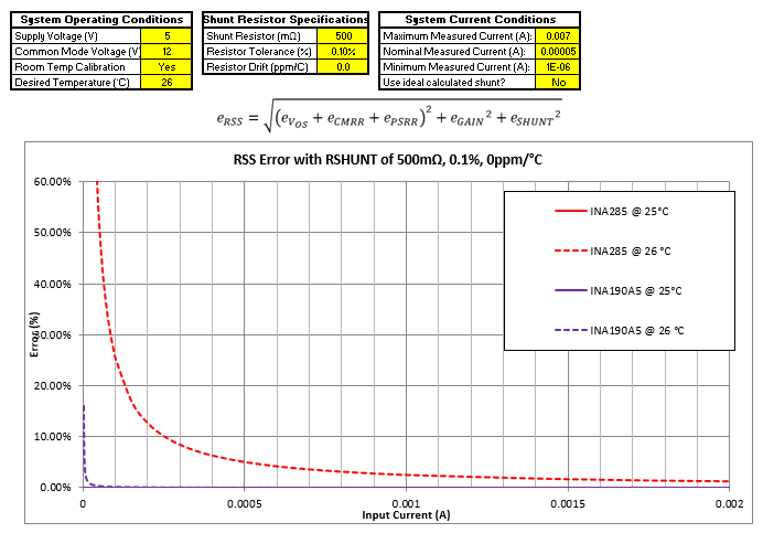

    As I mentioned in an earlier post, I still believe you will have better results with the INA190, and strongly recommend you look at this device for signals this small. I understand you are performing a calibration here, but even this is no guarantee of performance with signals this small on this device. I took the liberty of generating one last error curve. Notice the zeroed calibrated curves at a room temperature of 25C, and the bearing a 1C difference makes in the error from the calibration point:

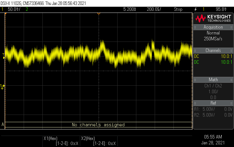

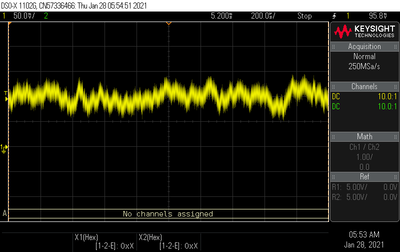

    I had a chance to look at this a bit on the bench today, and for my setup, while I am seeing amplification of noise, I am not seeing the periodic signal growing worse with Vcm that you are showing. Here is my setup:
    • Vs = 3.3V
    • Vcm = 3.2V, 5.0V, 12.0V, 24.0V
    • VSENSE = 0V
      • I control the inputs by feeding a direct precision voltage for Vcm to both IN+ and IN- to emulate the condition of Vcm while maintaining Vsense = 0V.
    • REF1 = REF2 = 100mV
    • Scope window was set to the parameters you've established, 50mV/div, 200us/div windows. My DSOX1102G tops out sampling at 250MSamps/s for 200us/div.)
    • I am NOT performing calibration here
    With this setup, I do see the noise swing on the signal at this level, but on my setup this looks to be much more random noise than a periodic signal. That said, I've reached out to our designers to see if they have any additional input on such a signal.
    3.2V (for a Vcm < Vs case):
    Vcm = 5.0V:
    Vcm = 12.0V:
    Vcm = 24.0V:
