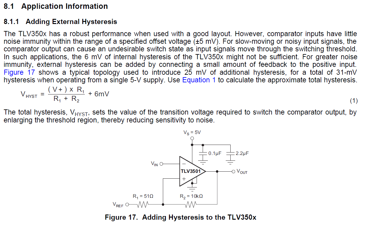

Now use TLV3501 to add hysteresis circuit, the high level of TLV3501 output is 5V. Need to connect TLV3501 output to 3.3V (or 5V) MCU IO port. Please recommend the circuit.

What I mean is that this circuit can be directly connected to the MCU IO port.
Still need to go through other conversion circuits.
I am assuming you are asking if the output pin can be directly tied to an MCO IO port.
The TLV3501 output should be compatible with your MCU IO port without a conversion circuit.
