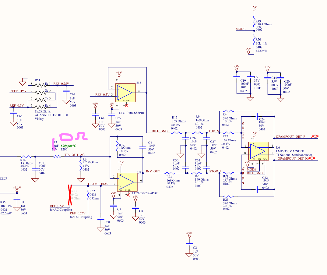

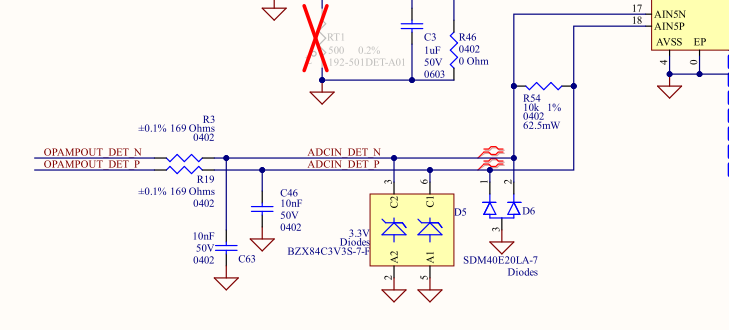

I have a LMP8350MA which I"m using to drive the inputs of a differential ADC. I'm using this chip to convert from a single-ended input signal (DC - 1kHz) to differential.
I am trying to remove a DC offset from my null measurement if possible. My null measurement has: VIN+ - VIN- = -400uV. This results in VOUT+ - VOUT- = -1.5mV. I've pored over the datasheet and cannot find the reason. I think the gain is generally correct (unity gain), but there's a differential offset or imbalance.
I am using a 2nd order LPF from "Fully differential amplifier design in high-speed data acquisition systems" which is a TI app note. The differential gain of this system should be 1. I've tried removing C26 and C30 on the offchance that they were causing the issue, but this change had no effect.
VOCM pin = 499.8mV, but output common mode is 501.3mV. The common mode input is 499.6mV. I am using a DC offset for the negative input because I wanted to prevent the DC offset caused by common mode mismatch, described in "DC Output Errors in a Fully-Differential Amplifier" which is a TI app note. I'm not concerned really about the small difference in common mode inputs and outputs since they are subtracted out. It's a little curious and I wonder if it affect my real problem.
I had thought the two paths were imbalanced since U2 and U13 aren't exactly the same circuit. I couldn't calculate that this effect would occur with unbalanced input impedance. I tested it out anyways, increasing and decreasing R15. I found that this made a small difference to the VOUT- voltage (where decreasing R15 was a step in the right direction). But it seems like the resistors need to change a lot to make a difference, so I think this isn't the primary cause of the DC offset in VOD.
Using the calculations from that app note, I'd expected the DC output error of this circuit with this differential amplifier to be 200uV typical at room temperature. What am I overlooking here?
