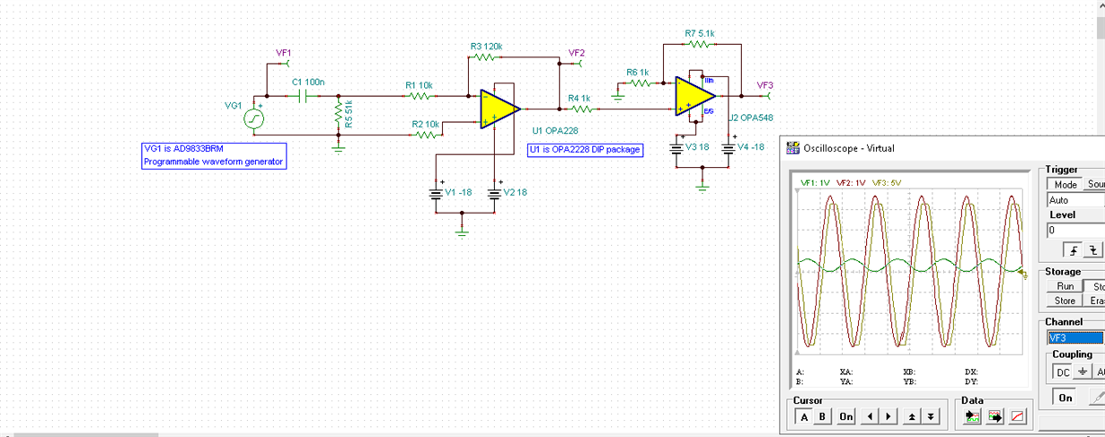

Hai,
I am using OPA2228 OPAMP in one of my Analog card. I am using the IC in inverting amplifier configuration with gain of -12. Input voltage is 100kHz ac signal 0.6Vpp sinusoidal, offset voltage is 0V. Supply voltage is +/- 18V. Recently I am facing issue with ICs. ICs are getting failed( zero output voltage) after working for some days. From the data sheet I am suspecting I am operating the IC at maximum supply voltage. Is that the only reason for failure. I have tried operating the IC at 17V also but failed after working for some days.
Can u please suggest me what to do to avoid the failures.
