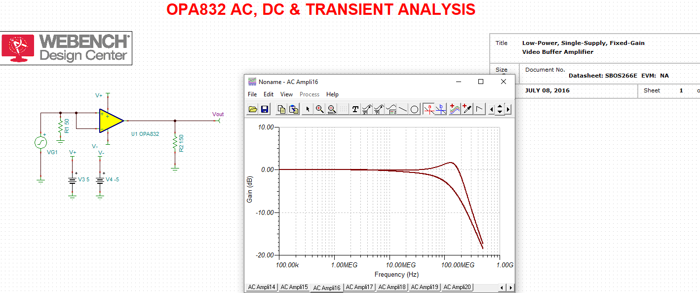

Hi sir,

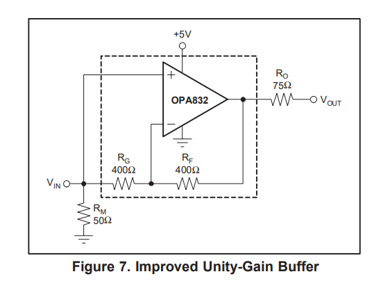

Mu customer have tried to simulate a very simple circuit (Figure 7) following a database of OPA 832 in TINA-TI,
however, with only positive single supply (+5 V) I could only observe half wave signal (input: 3V, 1Hz),
however applying dual supply of (+- 5V) gives full ac output. Can anyone help me to clear up! Thanks in advance.
Circuit file attached.
Could you pls give me the logical explanation on why it is not operating in the negative half cycle for positive supply only.
If that the case, is it possible to use this circuit as a half wave rectifier?

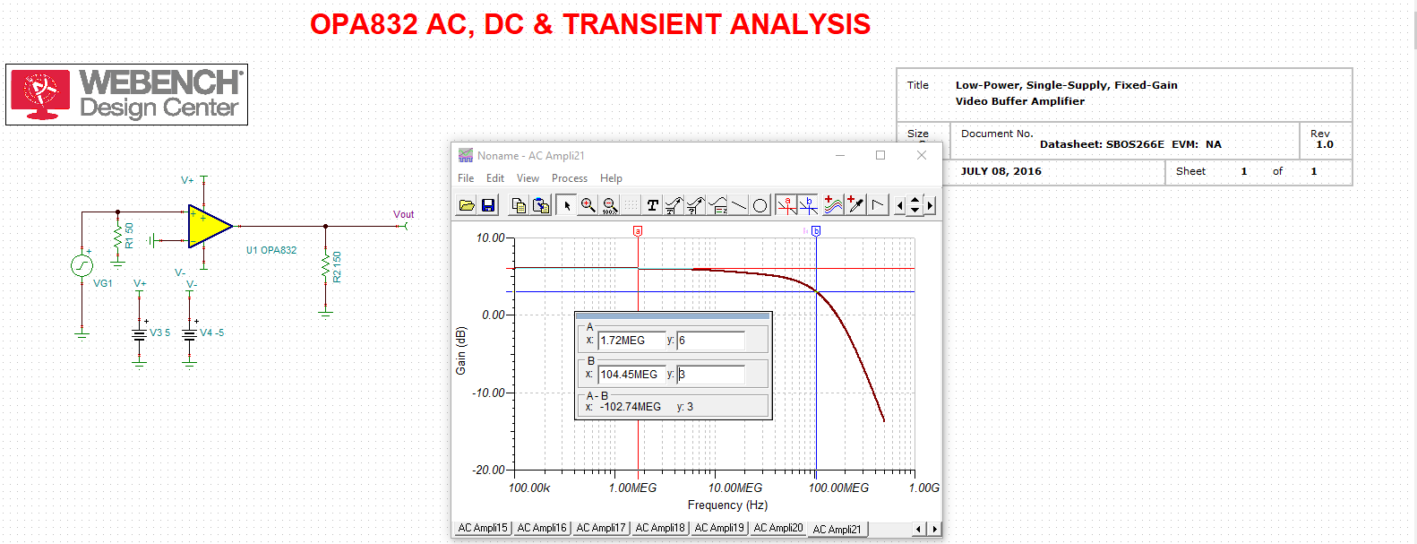

Furthermore, with increasing the input voltage (5V, 13.56MHz),
why I can not get the unity gain but works fine with 3V and modifying the circuit is not resulting double gain.
Any suggestions please!
