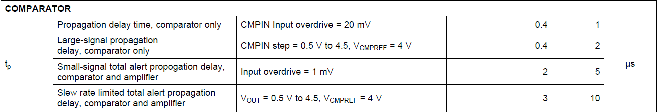

At datasheet of INA381, " The total system overcurrent protection response time provided by the INA381 is less than 10 µs."
Please review below question and let me know your opinion.
1. I don't understand about max 10us of the total system overcurrent protection response time but propagation delay is only 400ns. Is this caused by slew rate?
2. Which point is the boundary between Small signal and Large signal?
3. Slew rate limited total propagation delay, comparator and amplifier,
- What block is amplifier? Is this amp current sense amp for output?
- The 2V/us Slew rate is for current sense amp not comparator. Is it right?
4. Why Large signal propagation delay is for only comparator? On the other hand, why small signal propagation delay for comparator and amplifier?
5. Slew rate limited total propagation delay, comparator and amplifier, typ value is 3us but max is 10us. Why is there too much difference between typ. and max? Is this caused by variation slew rate?
6. Is there any solution to reduce the total system overcurrent protection response time less then INA381?
If you have an application note for propagation delay related to slew rate, small signal and large signal, would you please share it?
