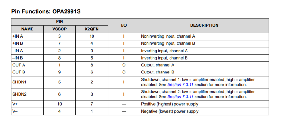

On the July 2020 revision of the OPA991 family datasheet there are multiple contradictory statements about the behavior of the shutdown pin in this family. Different active high/active low statements and designations for the multiple versions. So, ignoring all the other contradictory statements for the other versions, and just looking at the OPA991S specifically:
- Figure 5-3 (which marks the shutdown pin as NC) it denotes the shutdown signal as non-inverted and indicates that shutdown is active-low.
- Section 6-3 indicates that amplifier is enabled with a high-level on the shutdown pin (i.e., shutdown is active-low)
- Section 6-7 indicates that the the amplifier is enabled with a high-level on the shutdown pin (i.e., shutdown is active-low) and consistently denotes ¬SHDN as the pin name.
- Section 7.3.11 extensively describes the functionality as if the shutdown pin is active-high. Indicating that an internal pull-down enables the amplifier if the pin is left unconnected.
Which one is it then?
Is there an errata or a more recent version of this datasheet?
  • well on that datasheet, page 4 there is also this for the single, not clear
    but for the dual you get more on page 7, I think both of these are saying pulling the line low turns the part on and taking high turns it off.
    I would guess the table 6.3 is listed backwards and the specs are very confusing, suggesting a very narrow band close to each supply for each logic level - yea this needs to some work. The discussion in section 7.3.11 clearly is active low to turn the part on and it says anything above V- + 1.2 is off

  • Former Member
    +1 Former Member in reply to Former Member
    Hi Edgar,
    The OPAx99x devices are enabled with a logic low signal.
    I was able to get confirmation from the engineer that usually covers this part, but is currently out of the office.  I will push the engineers responsible for the data sheet to resolve this issue ASAP.
    Daniel
