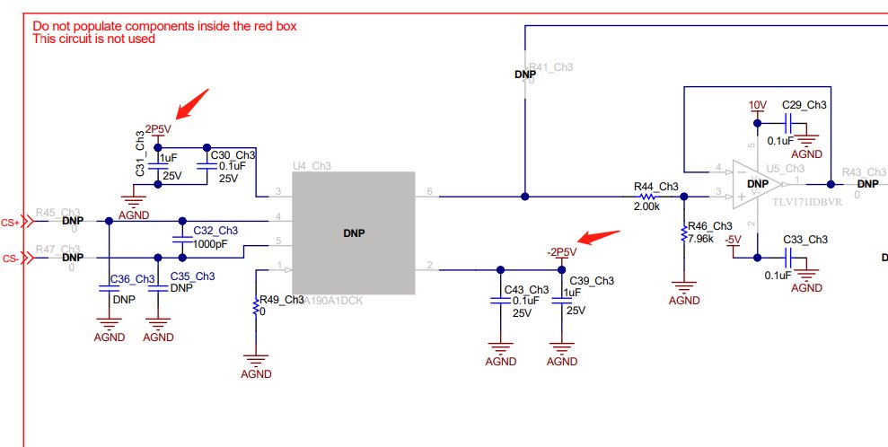

HI TEAMS
Please confirm it:
Can INA190 be powered by ± 2.5V?
Hello Kevin,
This should work. I would add a capacitor between pins 3 and pin 2 as close to the INA190 as possible. Make sure that all maximum voltages in the datasheet are referenced to the GND pin and you need to make sure you do not go beyond those voltage. From this diagram it looks like you are ok.

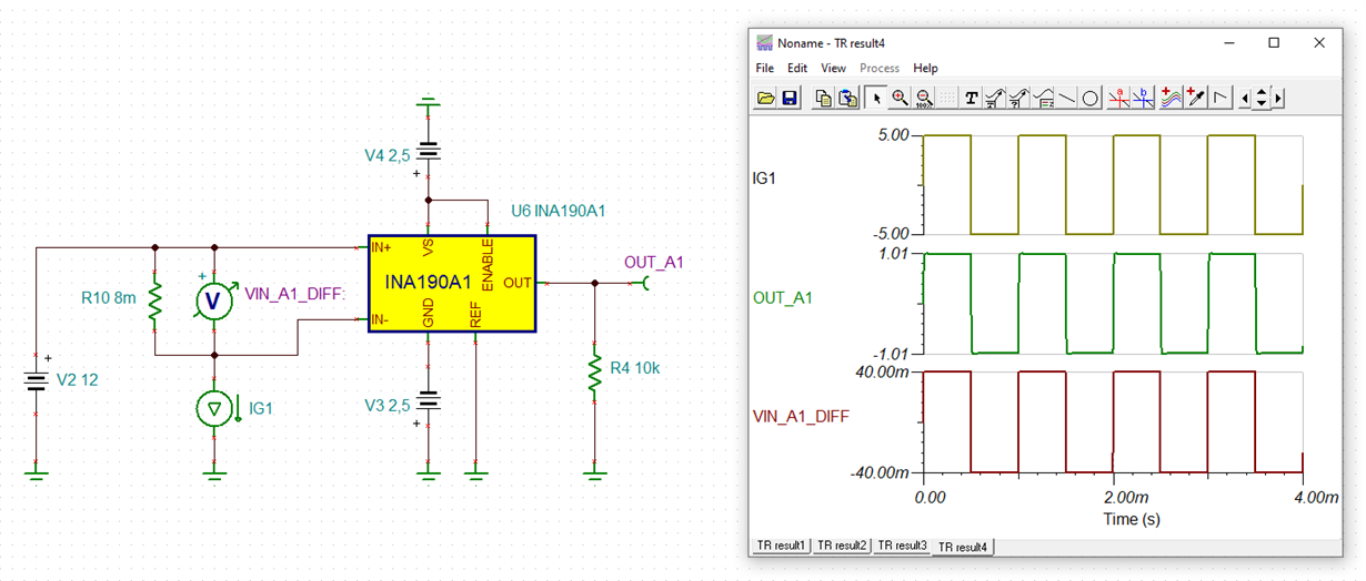

Hi Teams:
If you use positive and negative power supply, please confirm that you can collect positive and negative voltage and output positive and negative value?
(voltage ± 2.5V, input ± 40mv, amplification 25 times, output ± 1V)
Kevin,
Yes the output voltages will be confined by the voltages at the supply pins. So having a negative 2.5V on the GND pin will allow the voltage to get to about 1mV of the -2.5V due to swing low operations. Same applies the the output limitations on the high side with VS pin.
