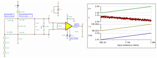

my customer wants to build a solution for radiometric measurement with a PT1000.
Requirements:
  • 4.5 - 8m wire between PT1000 and pcb
  • 2-Wire measurement is mandatory
  • external Ref
  • ADC should be the ADS1119
 He read the Document SBAA201- RTD Ratiometric Measurements and Filtering Using the ADS1148 and           ADS1248 Family of Devices. To build this he needs an external current source for ADS1119.
  • Q1: Are the recommended steps for common-mode and differential filtering enough to reduce emitted interference
  • Q2: Are there special circuits for the current source which have a good immunity against interference. The customer read about the current sources in SBVA001 and SNOA481b (3.1.1.1 Current Source)
Can you please also recommend parts.

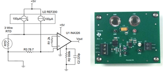

    REF200 is dual package current sources that are good for RTD application.. It will be better to use the IC package rather than design on your own, unless your temperature operating conditions is outside of a current source.

    I am enclosing 3-wire RTD application note below (it is 3-wire design, but it is also applicable for 2-wire application).
    https://www.ti.com/lit/ug/tidu969/tidu969.pdf?ts=1616776511847&ref_url=https%253A%252F%252Fwww.google.com%252F
    https://www.ti.com/lit/ug/slau520a/slau520a.pdf?ts=1616777373742&ref_url=https%253A%252F%252Fwww.google.com%252F

  • Hi Oliver,
    Thanks for your design requirements.
    I took your design requirements as a reference and implemented in the following Tina model. As suggested previously, I continue to use INA333 instrumentation amplifier for the RTD (PT1000) application. If you want to use higher voltage IA, we have that as well (which is comparable to INA333, such as INA821, INA818 or similar).
    The image below is the designed references that I used for the simulation.
    In the simulation below, I placed input differential LP filter at approx. 245Hz. The temperature change or response rate can be readily measured and monitored up to 25Hz. In addition, I assumed 28 gauge RTD and lead wire up to 8 meter in length. The RTD cable bundle will have better electrical and/or magnetic attenuation, if it is twisted and matched pair. The RTD simulation is driven with 100uA in constant current. If you want to drive PT1000 in 300uA, we can modify the simulation accordingly (also means that we may need use high voltage IA parts).
    The RC LPF filter has attenuation range between -40dB to -60dB. INA333 has additional CMRR up to 110dB, therefore, I did not spend a great deal to take care of simulated input noise, which I assumed 1Vpk. The RTD input circuit will have input noise attenuation up to -150dB to -170dB range, and the coupled common mode noises or interferences at the analog front end of INA333 will not be significant due to the design and the part selection.

  • Hello Raymond,
    thank you very much for your support and the valuable information.
    One question regarding the RC LPF filter you implemented in the simulation. You used the PT1000 resistance itself as filter resistance, right?
    Are there any disadvantages if additional filter resistors in the LPF stage are used and the filter capacitor values are reduced accordingly?
    In the simulation, the current source actually drives the RTD only, but not the wire resistance. To be correct, the current source must flow through the RTD and the wire resistances. The sensor cable actually is AWG20 (0.5mm2, stranded wire), so the wire resistance can be assumed smaller, approx. 0.27 Ohms per line.
    Kind regards, Oliver
  • Hi Oliver,
    Q1: You used the PT1000 resistance itself as filter resistance, right?
    Yes, this is my intention. I am trying to keep the input RTD leads in low impedance. Since the pair of wire is inside of a cable bundle, low impedance will have better noise immunity against magnetic and electrical induced noise and/or spike induced interference into the RTD sensor/cable. I am hoping that it will have better radiated and conducted susceptibility at high frequency as well.
    (The differential LPF is configured at approx. 250Hz, From 250Hz --> 2.5kHz -->25KHz --> 250kHz etc, you have a minimum 60dB attenuation up to 250kHz. If you are talking about MHz signals, the -20dB/decade roll off will continue to attenuate significantly. INA333's 100dB CMRR (DC-60Hz) works well at lower frequency, though it will start to diminish at higher frequency, see Figure 19 of the datasheet), but differential LPF will attenuate more significantly as input noise increases above MHz range.).
    The overall INA333's transfer function looks like this: Vout_RTD = Gain(V+ - V-) + Gain*Vos_max + Vos_DA + Vref, where Gain = 11, Vos_max = 25uA and Vos_DA = 75uA (2nd stage of Differential Amplifier in INA333), Vref = 1.25Vdc (say 200uA constant I is used, see the attached Tina simulation). In this case, I changed the constant current source to 200uA, where REF200 is the constant current source (combine 2x100uA into one 200uA current source).
    If you are able to increase Gain(V+ - V-) signal amplitude, the overall errors will be considerably small. As long as input signals or noises are behaving in common modes at the analog front end of INA333, it will be rejected by the part.
    INA333 PT1000 03312021.TSC
    Q2: Are there any disadvantages if additional filter resistors in the LPF stage are used and the filter capacitor values are reduced accordingly?
    The answer is partially replied above. If you insert small filter resistors (matched) within the RTD input signal, it is likely that IR voltage drop errors will be small or insignificant. If there is an error in the inserted filter resistors, the differences in voltage (200uA*ΔR) will convert from some of common mode into differential mode at the INA333's input, which it may affect the total temperature measurement errors.
    In additional, the temperature accuracy requirements are "PT-1000 has a sensor error of +/- 1.5°C @ 90°C", so I think that the  measurement errors mentioned above may be insignificant, if your filter resistors (low values) and RTD wire length are reasonably matched. Perhaps you need to reduce the differential capacitance somewhat, which it will increase the BW of the INA333 circuit or temperature response somewhat. (I do not have information about your temperature response characteristics of sensed object. Typically the rate of change in temperature is not very fast; and1Hz in rate of change in temperature is already very fast).
    Raymond
