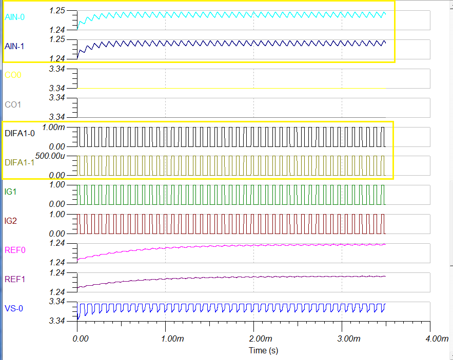

Analysis of INA240-A1 in two transient models; 1mohm shunt on one INA and 500uohm shunt other INA Pspice circuit. Oddly both models produce same output signal plot (1.24v/1A) shunt current.
How can output amplitude plot the same peak voltage if 1mv/A shunt on one, 500uv/A shunt on other INA? Is there Tina options switch change require to evaluate each Pspice model separately? Have I missed point shunts uV/A value controls amplifier output level relative to the REF1+2 voltage level? What have I done wrong to evaluate two different V/A shunts.

    Both circuits have an output offset, by way of the REF pins of 1.24V. In order to get the gain, you need to subtract this offset from the output. Once you do that you’ll see the correct gain for both circuits. Also, you may want to slow down the frequency so the output resembles more of a square wave instead of triangular.
    If you still have difficulty/questions, please attach your TINA circuit. It will help us understand your question better/quicker. In addition, it helps tremendously if you state clearly what the expected result is and what the actual simulation result is etc.

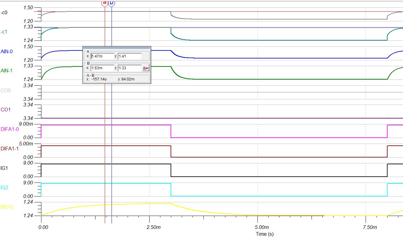

    To your second paragraph – The circuit has a bandwidth of 1.5KHz due to the filtering in your circuit. Your PWM is at 12.5KHz, far exceeding the system bandwidth. The output is not going to be an accurate  representation of the input. This is exactly why I asked to slow down the PWM in my previous post.
    Here is a plot with 8mS PWM, instead of 80uS. The two outputs and their difference are spot on.
    Regard, Guang

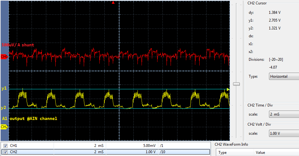

    The A1 400Khz bandwidth CMMR @12.5Khz=103db figure 12 of datasheet. The SAR filter R1/C7, R17/C18 represent only the SAR input capacitance are not part of the 15n input filter. If your idea was true the bench circuit would not produce the signal shown below which incorrectly has REF1+2 (1.225v)  added into INA output gain, opposed to Tina transient simulation models. Notice top INA (1mv/A) is 9mv/A and IG1/2 are 9 amps  deviates from the actual 8 amps peak being verified on the test bench.
    Imaginary math below capture produces correct 63mv (6.2A) if we "manually" subtract REF (y2) from (dy) as you mention first post. Final amplitude (y1) is incorrect as the INA is supposed to subtract (dy) REF not add it to 63mv (x20) gain. The INA output should be 1.3v 1.228v for 63mv @6.2Amps but not 2.7v otherwise INA is simply acting like an OPAMP being incorrectly called a current monitor.
    Something ain't right as we have more than 1 INA in the bench circuit. Fact is we have 3-A1 on test bench all 3 REF are being added into the amp gain. Ohms law states the parallel REFS reciprocal of the added reciprocals may in fact plague REF1+2 of more than 1 INA tied to a single voltage reference even with 6.8k series isolation resistors. So the internal REF resistors are being divided (parallel) with other INA amps in the very same circuit. Tina model seems to show the same results in a different way. Otherwise how can the INA higher output potential (REF added) be explained other than by Ohms law?

    The problem is Tina analysis is not plotting the bench effect of how multiple INA sharing the same REF being (incorrectly) added back into the gain when multiple INA exist in the same circuit. Ohms law "reciprocal of the added reciprocals" for parallel REF's is not being evaluated during transient analysis. The bench result for 6.2 amps should be 1.3v as Tina plots and not 2.7v as bench shows as that too violates our Tina model even for two INA sharing REF voltage source.
    If you check the scope capture above plain to see +1.225v REF was added to the +1.225v floor + 63mv making 2.7v, should be 1.3v.
