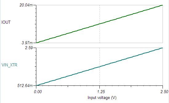

Hello Joc,
I suggest you use the XTR111 in the configuration shown below:
Here's the simulation file:
XTR111_2p5V_to_4-20mA.TSC

Hi Joc,
The trim circuitry you've included is correct and will be useful to calibrate each system.
You should choose resistors based on your application's requirements. If you need a high accuracy system, then you'll likely have to buy more expensive resistors and trim potentiometers. If the application needs to maintain high accuracy over temperature then you'll need to purchase low-drift resistors and trim potentiometers.
