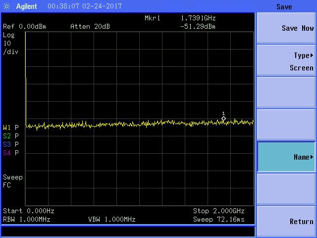

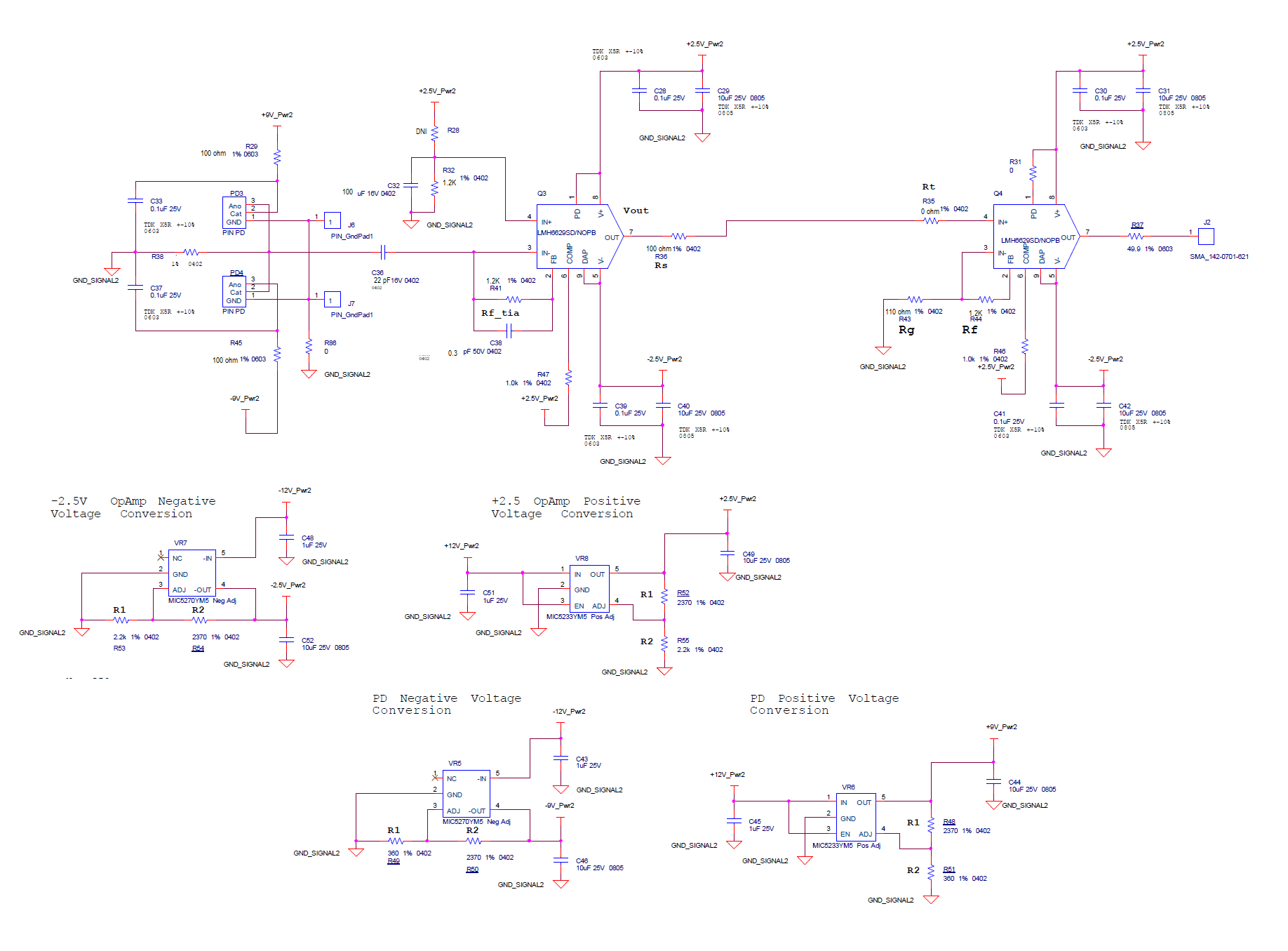

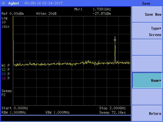

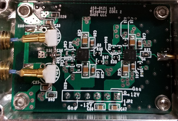

As shown in the following schematics, the LMH6629 has been configured/used as TIA (non-inverting configuration). We built several of them and we have been noticing a noise peak@1.73 GHz on few of them. What could cause this noise peak to occur at that frequency?
For more info:
Attached schematics, spectrum analyzer screen capture, and actual PCB board snapshot.
Please let me know if you have any questions or concerns.
Madhukiran Panabakam
NO Noise Peak Board: Spectrum Analyzer Screen Capture
Noise peak board: Spectrum analyzer screen capture
  • In all probability the amplifier doesn't have sufficient phase margin. This doesn't look like a typical TIA application..where is the actual input being applied to the circuit. Your schematic isn't coming through with good resolution. Can you please draw out your circuit (only the LMH6629 TIA part) in TINA-TI, detailing exactly how you are connecting the photodiode/SiPM to the LMH6629
  • Hi Samir,
    Thank you for the prompt response. I tried to create that circuit using TINA-TI but somehow LMH6629 TIA part is not in TINA with the same package. Anyway, the images which I attached are high resolution images. If you click on the schematics image it does show pretty good, and you can zoom-in if you want closer look of the part.

  • Hi Madhu,
       There is only a single model for both packages. This is close enough for initial study. You can open up the model macro by double clicking on it and checking what all is simulated and what isn't.
    Attached is a TINA circuit. Can you please answer the questions in the red text within the schematic and also confirm I haven't made any other mistakes in my setup. Once you do that I can run some quick tests.
    Also, when you mentioned "no optical input", please confirm if the diodes are still present, but you are not stimulating them in any way??
    Looking at the PCB it looks like there is a bit of inductance between the photodiodes and the actual amplifier input. This can be detrimental to a high-speed amplifiers stability. Please try to minimize this as much as possible. Can you also zoom out a bit so I can see where the actual photodiodes are?
    -Samir

  • Madhu,
      Attached simulation shows a phase margin of only 24 degrees implying possible oscillation. In addition to this the inductance from the photodiode leads could make things worse. For a start can you please reduce R38 to say 100 ohms and check if the oscillation goes away?

  • Hi Samir,
    We did following modifications and tests:
    1. R38 (100 ohm) : Peak still exists
    2. R38 (Short) : Peak still exists
    3. R38 (10 K ohm): Peak still exists, but disappears when we close the lid of the box.
    4. R38 (1K ohm): Peak still exists
    5. Cleaned Solder blobs: Peak still exists
    Please let us know if we are missing anything in this.
    Best regards
    Madhu

  • Hi Samir,
    As per your suggestion, we tried step 1 and here are the results of the test:
    NO-PhotoDiode; R38:1K
    Same with/without LID
    NO-PhotoDiode; R38: 100 ohm (Noise peak @1.5569GHz, -23dBm)
    With Lid
    Without Lid

  • Hi Samir,
    Here is the result for 200 ohm. I zoomed in (2/div instead of 10/div). Anyway I attached all three plots .
    200ohm- 10/div
    NO-PD-200OHm-WITHOUTLID
    No-PD-200OHM-zoomedin-WITH LID
