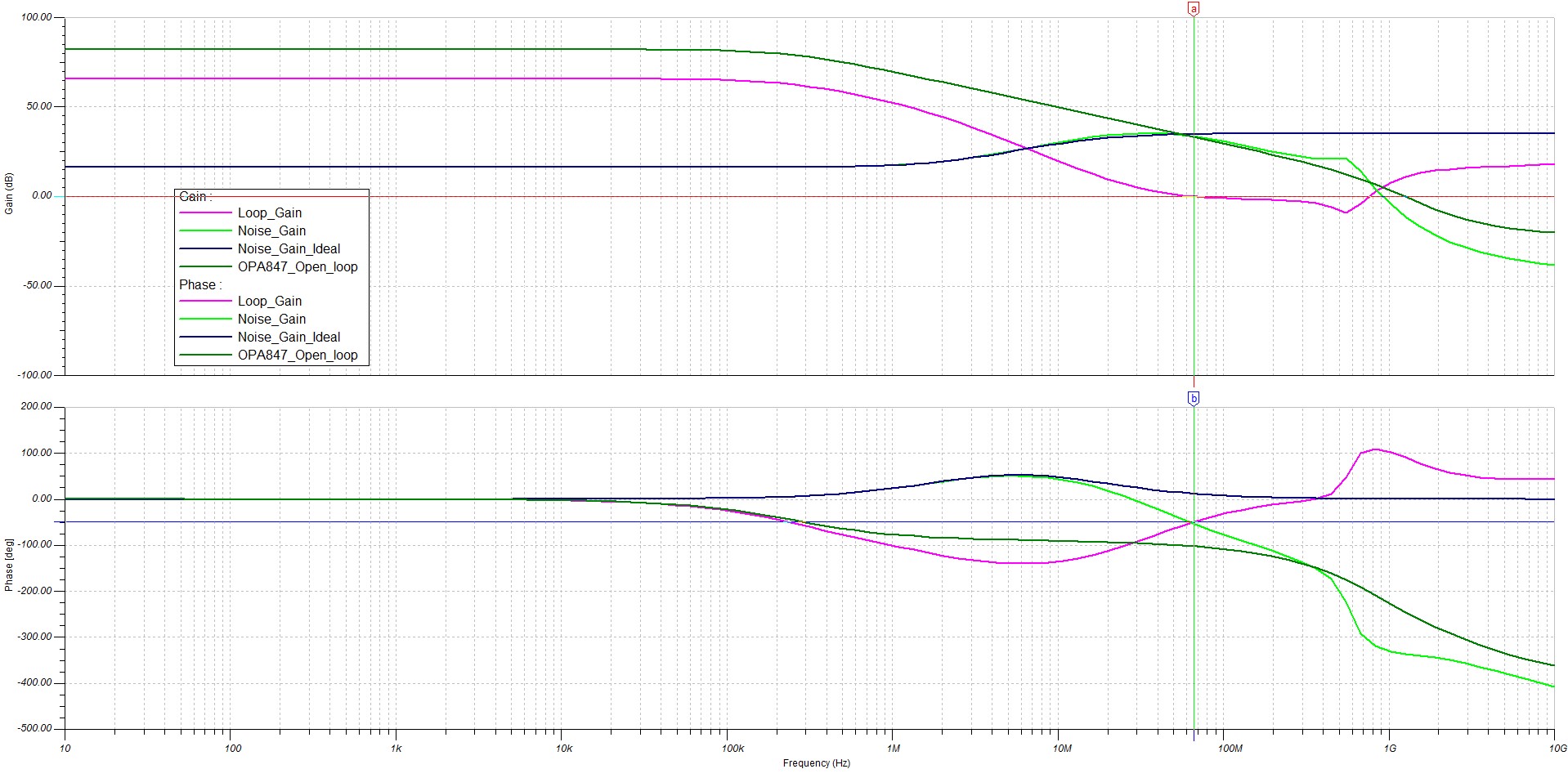

  • Hello All,
    With non-unity gain devices (like the OPA846 and the OPA847) in a transimpedance configuration, if you raise the feedback capacitor too high, you can lower the Noise Gain pole frequency such that the crossover frequency can occur at below the minimum stable gain of the device (i.e. 7V/V for the OPA846 and 12V/V for the OPA847). This could cause instability in and of itself! Not enough feedback capacitance, could lead to instability due to excess phase shift around the loop (which is a different mechanism) due to the action of the feedback resistor looking into the amplifier inverting input capacitance. So, there is an optimum value for CF.
    You can use TINA-TI simulation to predict this effect as outlined in this post:
    http://e2e.ti.com/support/amplifiers/high_speed_amplifiers/f/10/t/333642.aspx
    The image below shows simulated Noise Gain and Open Loop response with CF varied (0.3pF, 1pF, and 3pF) using OPA847. You can see that 0.3pF is not high enough and the rate of closure is about 40dB/ decade and OPA847 will be unstable. With CF= 3pF, the Noise Gain intercepts the open loop gain at close to 483.2MHz where the open loop gain is about 14.1dB (=5.1V/V) which is below the 12V/V minimum stable gain of the OPA847. CF of 1pF is just about right in satisfying both the minimum stable gain criteria as well as 20dB/decade rate of closure (indicative of excessive external phase shift).

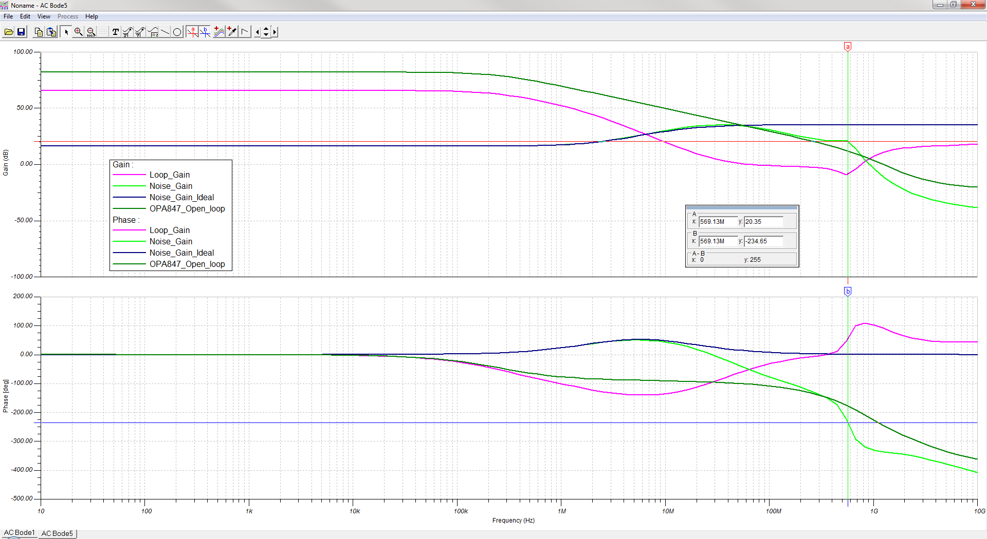

  • Hi Samir,
    sorry for the late reply. Here you have my circuit together with the Bode plots. I followed the steps indicated in another post by your colleague Hooman Hashemi (http://e2e.ti.com/support/amplifiers/high_speed_amplifiers/f/10/t/333642.aspx).
    As you can see in the bode plot, the Loop_Gain curve has a phase of -50º at 0dB crossing (66MHz) which means that there is still a big phase margin. However, in the Noise_Gain curve, which is extracted using the OPA847 model as shown in the schematic, there is a strange peak @ 570MHz that I did not expect. I took into acount that this OPA847 is stable for gains >12V/V and this is also respected as seen in the plots where the point where the noise gain joins the open loop gain I have around 50dB.
    The problem comes when I implement the my transimpedance amplifier and I put this Cf value in it. AT that moment, the ouput of the transimpedance amplifier starts to oscillate at a frequency 670MHz which is quite close to the peak found in the noise gain curve in the simulation. I don't understand why this peak comes up where I expected to have the noise gain gently following the open loop gain after 1/(2*Pi*Cf*Rf).

  • Hello Isaac,
     From your schematic it looks like your Shunt Resistance of the photo-diode is 100Ohms and the Junction Cap of the photo-diode is 950pF. Are you sure these numbers are accurate?
    Samir

  • Hello Isaac,
    1. I played with the numbers for the 100Ohm shunt resistor and dont see an issue. With the 950pF capacitor in parallel the effects of the 100Ohm arent critical at the frequencies where the AOL starts to droop.
    Now with regards to the oscillation, is it possible that there is load capacitance that you are not taking into account in your simulation which may be pushing the amplifier into instability?
    Can you bump up the feedback capacitance to around 30pF and see if it removes the oscillation? What I am trying to do with the 30pF is trying to get your loop gain crossover to be about mid-way between the pole in the 1/beta of the noise gain curve and the 2nd pole in the Aol of the OPA847. This seems to have a small improvement on the phase margin; it also seems to reduce the sag in the phase at the lower frequencies.
    Could you please send me a screenshot of the oscillations?

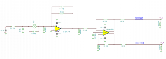

  • Hello Samir,
    here I attached the full readout channel. After the transimpedance amplifier, there is a differential stage using the LMH6551 to send the signals to the readout boards. However, while testing the circuit, they are going to a scope with the channel teminated at 50Ohms.
    I will try to mount a capacitance close to 30pF but if I remember correctly I already tried with values close it. However, I will try it again. Here you have the oscillations I see in the scope:
    In the screenshot, the BW is limited on the scope but if I use the full BW of the scope then I have even wider oscillations with an amplitude of 20mVpp or even more.

  • Hi Isaac,
    Thanks for the detailed explanation. I reran the simulation with the 100Ohm load resistor and it seems to have minimal effect on the loop gain response. I do not have a photo-multiplier tube that I can use in my circuit, however what I would like to do is to test the OPA847 in the lab here with 950pF & 100Ohm shunt and 560Ohm and 17pF feedback,  with a 100Ohm load resistor.
    1. Can you please confirm that even with the PM un-excited you see the oscillations?
    2. Also, please disconnect the TIA from the LMH6551 circuit and confirm the oscillations are still there.
    3. When testing with the scope is the scope 50Ohm terminated or high impedance terminated? I would recommend putting it in the High Z mode if you arent already doing so.
    4. Finally, when probing the output with the scope are you probing directly on the output of the TIA? This will add some load capacitance on the output, so I would add some series resistance to the scope probe(use a 500Ohm through-hole resistor). This will isolate any probe capacitance from the scope output. I ran a simulation with a 10pF load cap and I do see a strange peaking at around 580MHz. I have attached my simulation with this email.
    Samir

  • Hello Isaac,
       We tried all day yesterday to come up with method to stabilize the OPA847 with RF = 100Ohms and Cin = 950pF, but were unsuccessful in stabilizing. Similar to what you saw,  with no feedback capacitance it looked to have very tiny oscillations and with 10-30pF capacitance we observed oscillations in the 660MHz range. For capacitances in the 1pF-5pF range we saw large signal oscillations in the 5MHz range.
    We consulted with some of the senior engineers and on their advice modified our TINA model to have a series 3nH inductor in series with the 950pF Cin. If you plug that into the simulation you will notice the noise gain characteristic starts to do some very funny things which affects the loop gain of the TIA. The 3nH is meant to simulate trace and bond-wire parasitic inductance as well as any lead inductance from the PMT with its parasitic cap. Usually we ignore these inductances, however because of the large Cin it creates  resonance at much lower frequency values.I  believe this is why we are having such a hard time stabilizing the part.
    Could you let us know what the bandwidth of your application is so that we might be able to suggest a different opamp? Also, what is the model of the PMT you are using?
    Samir
