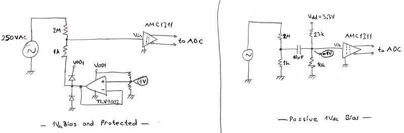

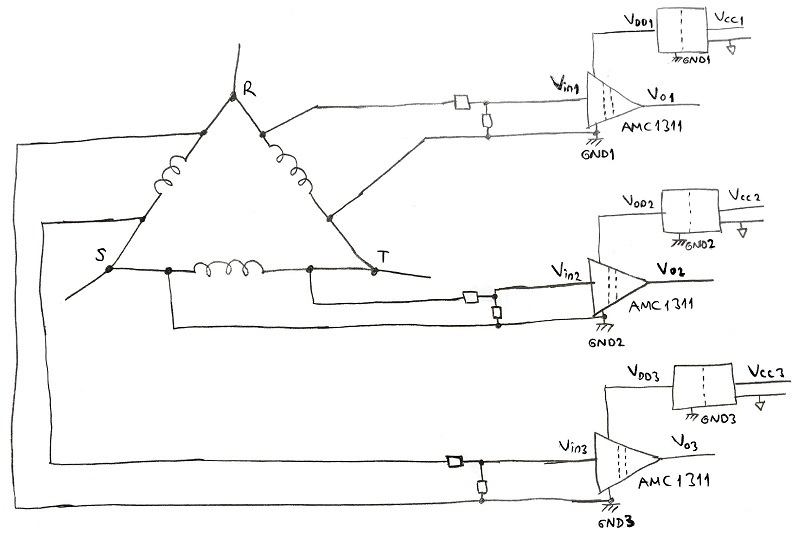

A customer request a 3Phase-3Wire (no neutral) 250VAC/60Hz isolated voltage measurement device.
I'd like to ask if AMC1311 is suitable for it as seen drawing.
(sorry for bad drawing, AMC1311 would have diff. output)
Thanks.
