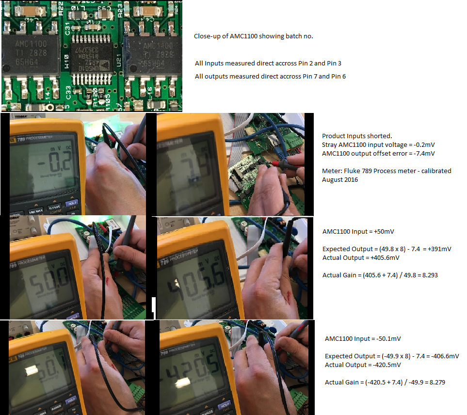

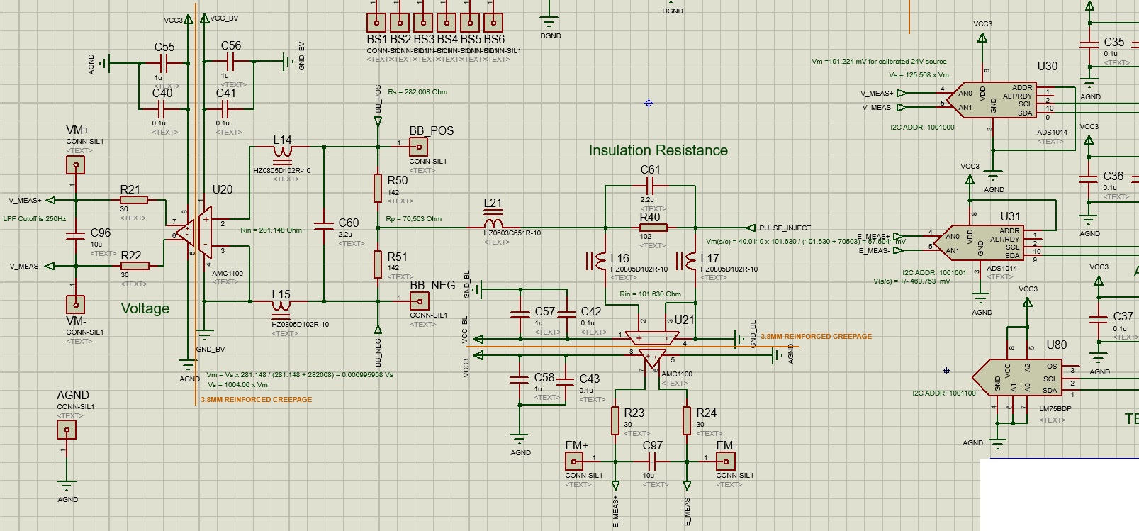

We have observed something odd though. In the attached circuit the AMC1100 are exhibiting a gain of around 8.3, We have had 5 prototype boards made from the same batch of chips, and they all display the same behaviour. Luckily for me the ADS1014 that sits downstream of the AMC1100 can sample up to the 3.3V supply rail, so I still make the product spec in terms of usable range. There seems to be no other issues. Linearity and offset both appear within spec.
Our scope is not very accurate, so the following readings were taken at DC using a stable power supply and a calibrated volt meter.
Short the AMC1100 input together, measure the differential output offset. We read 6.3mV, high, but in spec.
Apply +100mV across the inputs. Expecting 806.3 mV at the output, however we get 836mV,
Apply -100mV accross the input. Expecting -793.7mV at the output, however we get -824mV.
Supply rails are correct and stable.
Any ideas? There is simple LPF between the AMC1100 and the ADS1014. The minimum input impedance of the ADS1014 is about 70k Ohm.

    On the AMC1100 gain issue, can you tell me if you see the same ~8.3 gain variance in both your E_MEAS and V_MEAS circuits? Also, can you let me know exactly where you are shorting the inputs together? Is it directly at pins 2-3 or is it back further in the circuits?
  • Yes, 8.3 on E_MEAS and V_MEAS on all prototype boards. The shorting occurs further back in the circuit, so I acknowledge there is some additional stray offset currents present at Pins 2 & 3 during this procedure. Indeed it drops to 2.3mV when I use a screwdriver to short pins 2 & 3 on the PCB.

    Thank you for confirming! I could see the gain being off a little by the size of your shunt - the input to the AMC1100 is ~28k (see Figure 31), but that does not get you up to to the 8.3 level. Can you tell me what the marking on the AMC1100 chip is (or send a snapshot) and I'll look over the QC/production logs to see if this particular lot of devices is running high on the gain specification.
  • Requested info attached, along with photographic evidence of the phenomenon.
    The ADS1014 agrees with these readings to within 2LSB.
